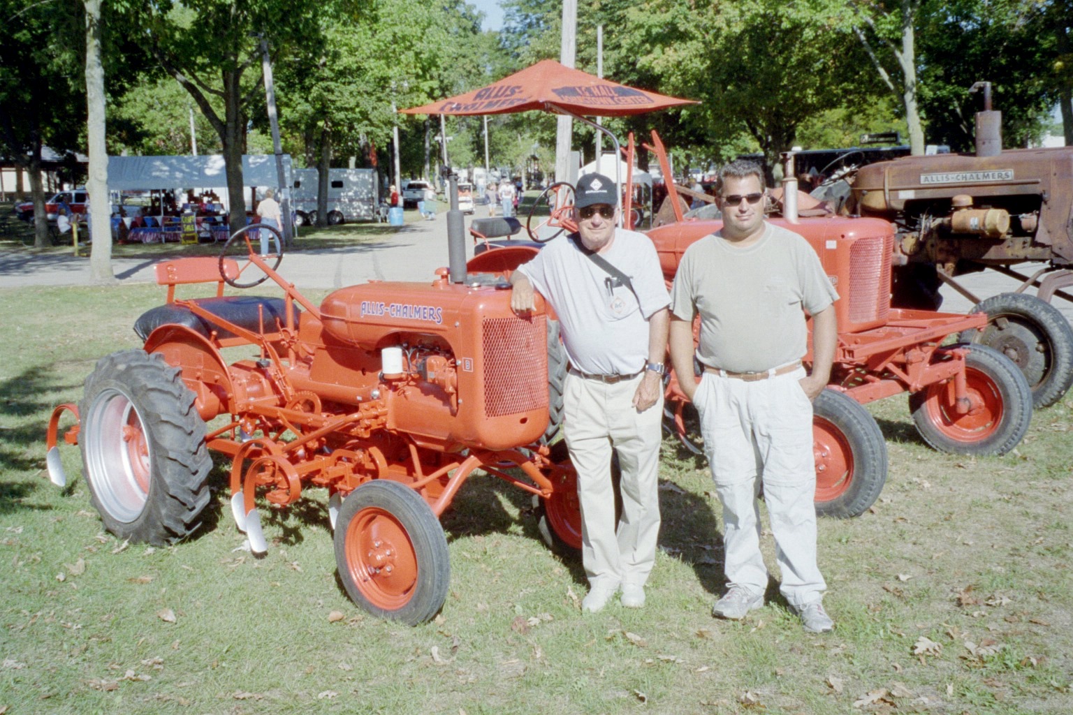

Posted By: Bill Long
Date Posted: 20 Feb 2020 at 4:27pm
Congratulations!!!  You have obtained my favorite Allis Chalmers Tractor - the B.  The information above is very accurate and most helpful.
I can only add as you now know you will find this forum to be most helpful to any of your questions - especially on the B.
As to the hydraulics facing forward check the right side of the PTO.  You should have either a plate bolted on, a blank area - if so no Hydraulics - or a hydraulic pump.
If you want implements you would need to find a plow, perhaps a cultivator, a snow plow blade, and a mounted rotary mower.  They are available but can be hard to find
Take good care of my favorite.
Good Luck!
Bill Long
ps:  a picture of my son and I with Mr. Lupno's B with a mounted cultivator.
