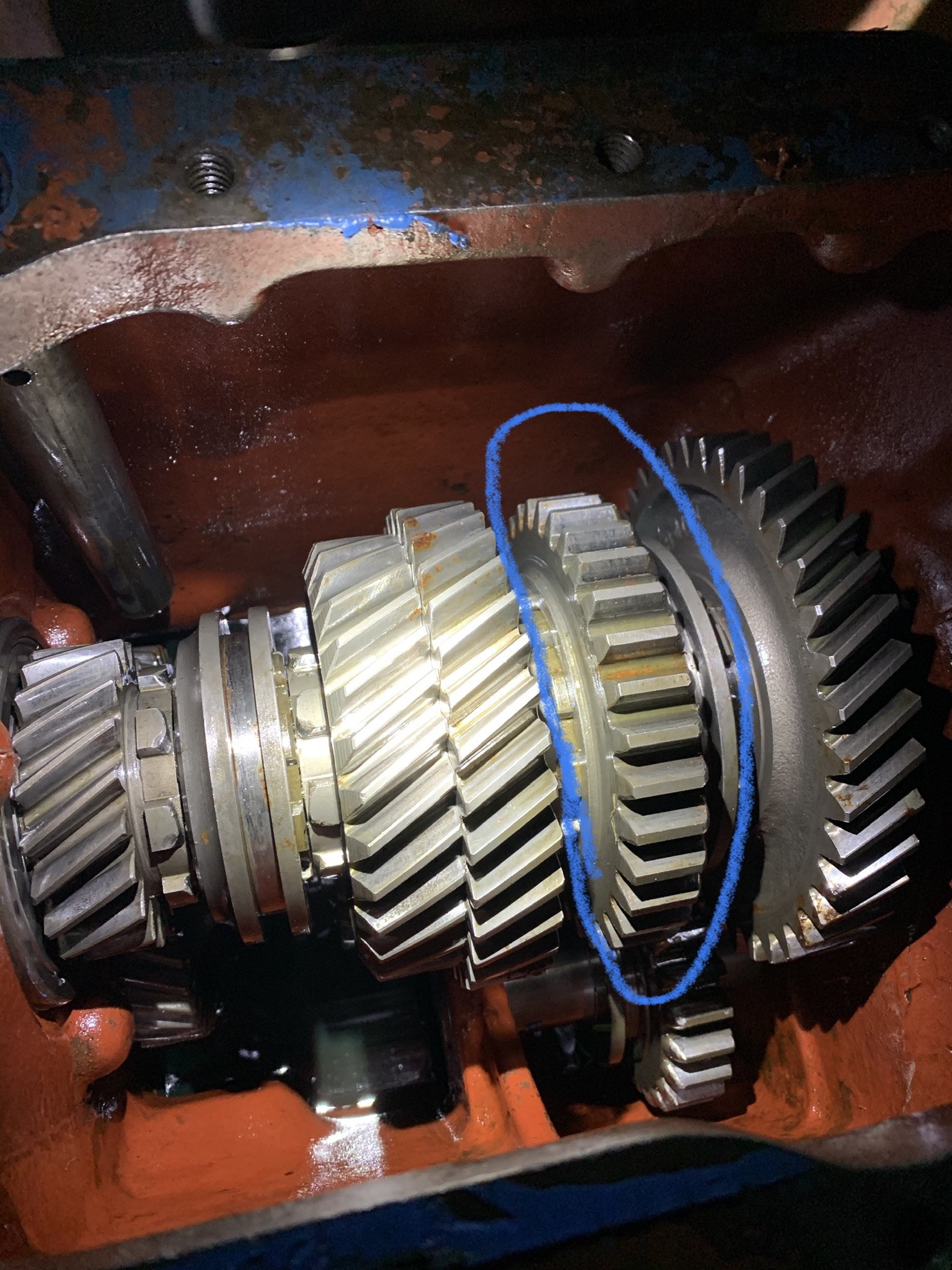

is this gear supposed to spin free when clutch is pushed in with tractor off??All other gears on shaft do.

No

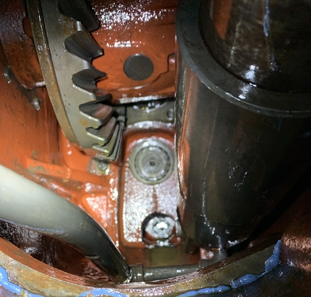

The teeth on ring gear face to the right (looking from rear of tractor). The illustration in manual is vague on which direction is front .

Post Options Post Options   Thanks (0) Thanks(0)   Quote SSD17 Quote  Post ReplyReply Direct Link To This Post Posted: 22 Jan 2020 at 4:58pm
Points: 23613
Post Options Post Options   Thanks (0) Thanks(0)   Quote DrAllis Quote  Post ReplyReply Direct Link To This Post Posted: 22 Jan 2020 at 5:06pm
Will work either way, but that way ain't right for a farm tractor.

Thank you DrAllis! I guess I will be pulling finals and swapping it around! I’m beginning to to think there are some missing parts in transmission!

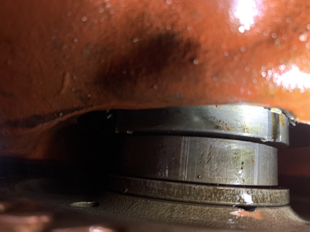

The lock nut was loose and I believe I’m missing a thrust washer

Post Options Post Options   Thanks (0) Thanks(0)   Quote CTuckerNWIL Quote  Post ReplyReply Direct Link To This Post Posted: 23 Jan 2020 at 8:07am
That is what drives the reverse idler gear when it is shifted into reverse and has to be locked into the top shaft at all times. The 4 other gears have a shifting collar that lock them into the top shaft when shifted into each forward gear.

Post Options Post Options   Thanks (0) Thanks(0)   Quote SSD17 Quote  Post ReplyReply Direct Link To This Post Posted: 28 Jan 2020 at 5:04pm
The main shaft snap ring (#23) was missing. Is there a way to see what thickness I need since there are 5 different options for it?
Points: 9238
Post Options Post Options   Thanks (0) Thanks(0)   Quote SteveM C/IL Quote  Post ReplyReply Direct Link To This Post Posted: 28 Jan 2020 at 5:21pm
I think the procedure  was to measure end play with feeler gauge to figure out thickness. This assumed you had the old snap ring in place.. Don't have the specs but the least amount of play you can get is what you want. Need a tad but not floppy. A factory manual should say what you need.You may have to find one that fits shaft and measure up from there.

You want the thickest one that you can tap/pound in with a small hammer and punch.
