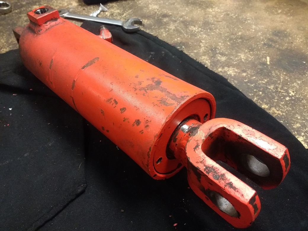

Update...I took the right cylinder off since I could access the front hole on that one. Figured I could practice getting the internal snap ring off on that one so I could do it blind on the left one. Took the elbow off and I don't really see a definite ring to remove. There appears to be several grooves, almost like threads? Really tough to see through the fitting hole and in addition they are shifted to one side of the hole, not directly underneath. Can anyone look at the picture and tell me if this is the type of cylinder with the internal snap ring? I am not sure if they are original to the tractor.

That is the original cylinder to the tractor.  I do not have a 100 series tractor with a cab, but I did the cylinders on my 185 last winter and it was an easy job to remove the battery box.  That gave a lot more room to access the cylinder pin.  I needed that space.  The front pins were rusted solid on both sides.  Was a hell of a job getting those things loosened up.

Thanks DSeries4. The ring clip that is supposed to be under the fitting hole, it supposedly moves into a deeper groove to give clearance to remove the rod? Is that groove towrd the front or rear of the cylinder? In other words, does the ring get moved to the front or rear of the cylinder (pretending it is still on the tractor)? Also, how on god's great earth do you get the ring back on after reassembly?
Points: 22742
Post Options Post Options   Thanks (0) Thanks(0)   Quote DrAllis Quote  Post ReplyReply Direct Link To This Post Posted: 03 Jan 2020 at 8:39pm
The cylinder in that picture is the old design that takes a spanner wrench to remove the nut on the outside and once pulled apart, the nut on the inside. Loctite inside nut or it will work loose.

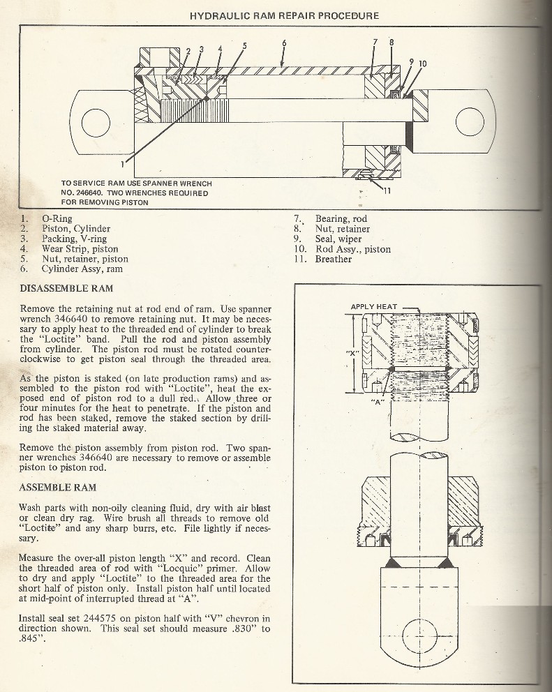

V- packing stack.  Same as most all series 4 D-17's or 190XT's.
JC-WI View Drop Down
Points: 34593
Post Options Post Options   Thanks (0) Thanks(0)   Quote JC-WI Quote  Post ReplyReply Direct Link To This Post Posted: 03 Jan 2020 at 9:29pm
You need a spanner wrench that goes in them two holes on the outer end of the tube... in the threaded collar, and turn it out and then the whole rod will come out of tube... Put new seals in and put it back together. And the seal kit for that cylinder form ACGO will have instructions in it...
Remember that you need the seals for the small Rod cylinder, not the big bore rod..
Points: 22742
Post Options Post Options   Thanks (0) Thanks(0)   Quote DrAllis Quote  Post ReplyReply Direct Link To This Post Posted: 04 Jan 2020 at 4:56am
Use plenty of grease on the new packing and try to screw it back into the barrel to minimize damage to the new V-packing.

Thanks guys. That diagram and instructions help a lot. I'm not coming up with any results when searching for that spanner wrench. Anyone have any insight as to a modern part number for it?

Just like Alvin, I rebuilt mine right on the tractor... No hose removal, No taking cylinder off brackets, just pull the pin on the lift arm side and raise the 3pt arms up and out of your way and then use a spanner wrench to take the end cap off and slide the rod out and work on it.
 Spanner wrench will look something like this or equivalent item homemade to do the job...
 And you can do it for the cost of the seals and the wrench /time.

You still need a spanner wrench to replace the seals inside and it is the same wrench used to disassemble.

From picture, the spanner holes do not look to bad yet, but you do need a good solid spanner tool...
One man's answer to getting a spanner wrench...
An adjustable spanner, not my preference for this spot, but it might work like a charm.
 -Going back to the instruction book above, it talks about locktite... I have not needed to heat any of the cylinders to take apart that I have put seals into... and did not put locktite on afterwards either.
