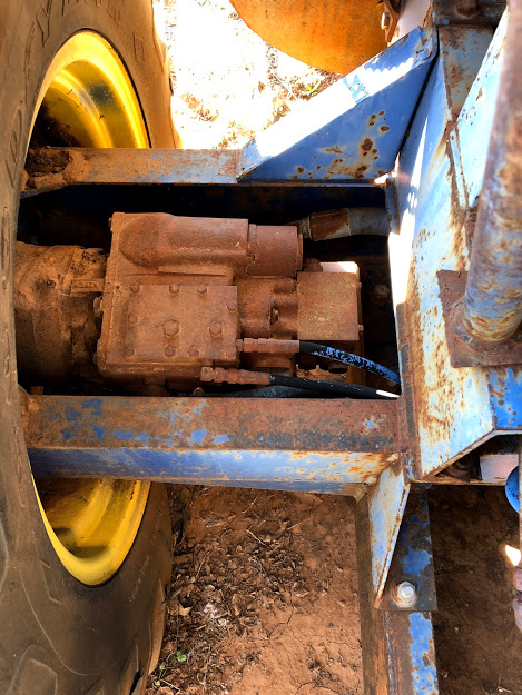

Dr, is this like what you're talking about? It's an old cotton harvester that is fully hydrostatic with no type of gear transmission. Just 2 motors on each drive wheel. How would you pull something like this without damage, being as there's no transmission?

I'd bet NO! My zero turn has hydro motors driving each wheel. Can not move it by pulling without sliding tires. There are hex fittings to turn out 5-6 turns to tow. It then free wheels nicely.
