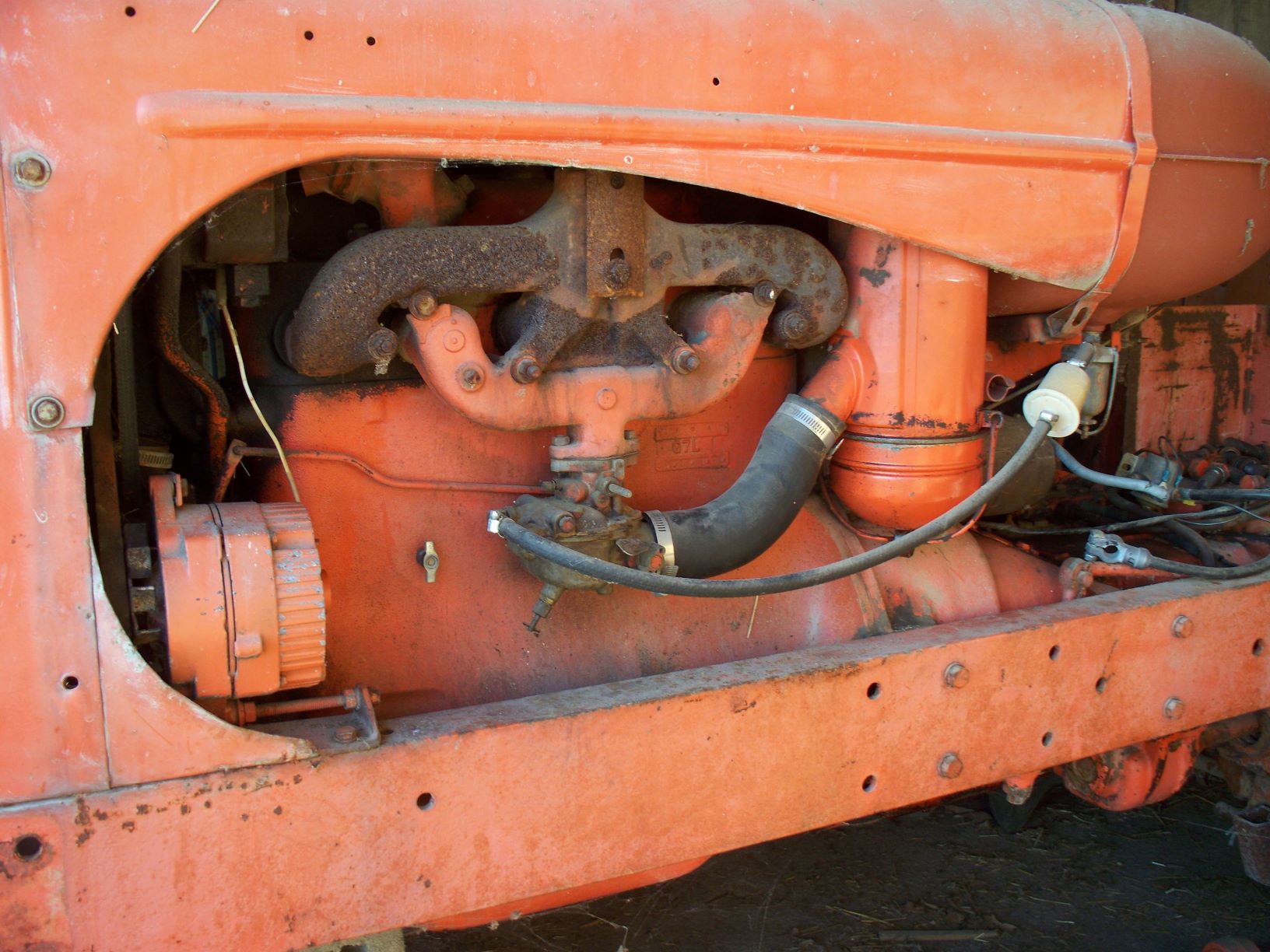

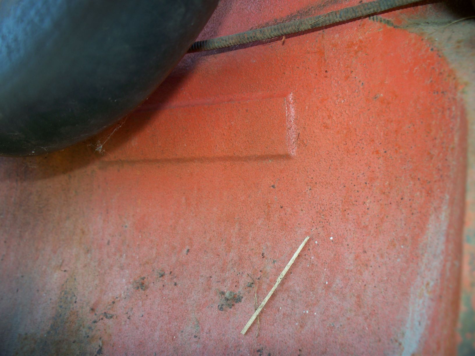

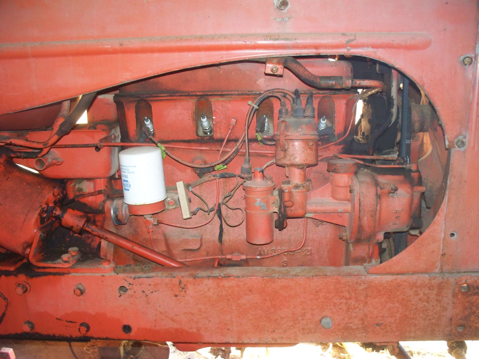

Here are some more pictures of the engine I am trying to identify. The last picture is of the raised area by the air cleaner where the engine serial number should be but it is blank. To me the engine looks like a standard WD-45 but I don't have one right beside it to compare. The tractor SN is WD-229446 which should be a 1956 model. The left side of the block has "G7L"f and the right side "AM-3858-2" raised in the casting.
     Thanks for your help, Russell.

I have 2 -- 45's sitting here, They are either 55 or 56. Probably could look at casting # on them if it would help any!

"AM-3858-2"
Actually what I'm reading from the photo is AM3858 21. Maybe I'm seeing it wrong.

     I have 1954 tractor SN-186606, engine casting #AM-3853-1 with a 2 beneath and engine SN WD-44286G.
     Also a 1955 tractor SN- WD-192493, engine casting #AM-3853-8 with a 1 beneath and engine SN 45-22499G.
     Tim, I was thinking that could be a 1 also but am leaning toward it being the end of the area with the number.
     ACfleet, if you had the casting numbers for your tractors it might be interesting.  I am wondering if the "AM" is the prefix for WD engines?
     Could my motor in question be a  new factory replacement and not have a serial number for that reason? Seems strange that the area for the number is raised there but nothing on it. Wonder too if the D-17's have AM casting numbers.

If there is no S/N stamped, that means the block was replaced with a new block at some time in the past. The usual reason was a tractor that didn't have antifreeze in it.

 As mentioned: Looks like a replacement block, WD 45 style. As far as whats in side you need to check the stroke. 4 inche stroke = WD crank, 4.5 inch stroke = WD45 crank.
Should be able to spin it real good with a 12volt system. I have a block like that in my WD45, no serial number on the block.

Your tractor Ser. # makes it a 1956 WD-45.
I believe the first 4 digits of the engine casting number should be 3853.
I have a '56 WD-45 (Ser.#223202) with a block casting #3853-10 and a blank Ser. number.
I also have a '56 WD-45 (Ser.#229500) with an engine Ser.#45-89836-G........
I'm guessing that one and yours must not have been too far apart coming down the assembly line.
