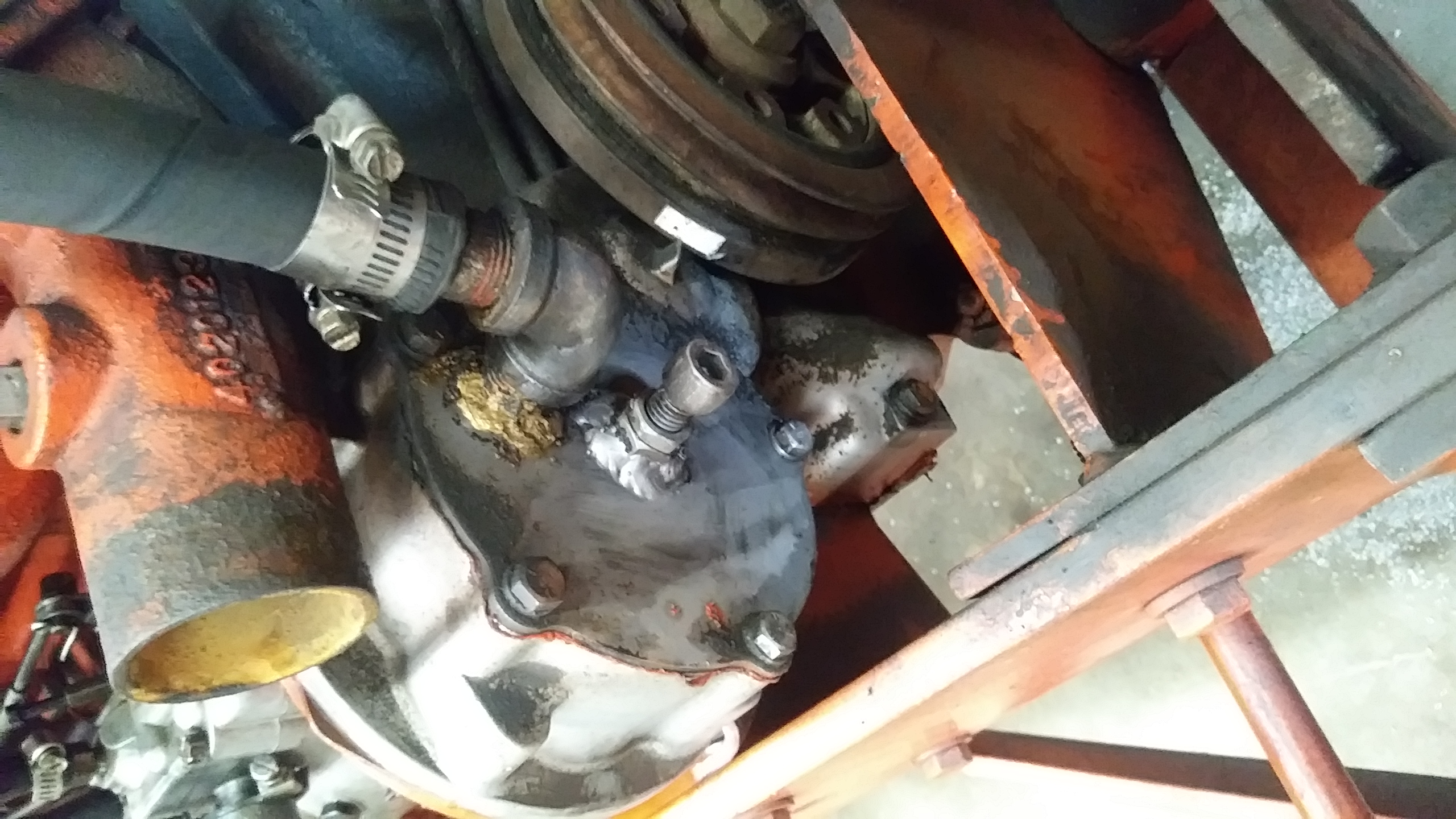

What is this bolt 190 injector pump cover pic now
Points: 8423
Post Options Post Options   Thanks (0) Thanks(0)   Quote DougG Quote  Post ReplyReply Direct Link To This Post Topic: What is this bolt 190 injector pump cover pic now
    Posted: 06 Aug 2019 at 6:15am
Wondering what this bolt is for on a 190 diesel puller with a 450 pump head , its on the injector pump cover
Edited by DougG - 06 Aug 2019 at 7:00pm
Tim-tn View Drop Down
Location: West Point ,TN
Points: 206
Post Options Post Options   Thanks (0) Thanks(0)   Quote Tim-tn Quote  Post ReplyReply Direct Link To This Post Posted: 07 Aug 2019 at 2:58pm
It screws up against the end of the pump drive shaft/gear supposed to keep the shaft from coming forward and seizing the shaft to the cover and then twisting the shaft off. I have a 450 head on my 210 with high charge pressure and have never had a problem without a bolt.
Points: 8423
Post Options Post Options   Thanks (0) Thanks(0)   Quote DougG Quote  Post ReplyReply Direct Link To This Post Posted: 07 Aug 2019 at 6:11pm
I gottcha, I had a 450 setup on a 180 that ran 200 lbs of pressure and still had the spring with no problems , how much pressure is this set up you think ?
Points: 22551
Post Options Post Options   Thanks (0) Thanks(0)   Quote DrAllis Quote  Post ReplyReply Direct Link To This Post Posted: 07 Aug 2019 at 7:45pm
That design (when I have seen it) was used with the internal transfer pump was left out of the RoosaMaster pump and an external supply pump was used to charge the Roosa.. It saw to it that the rotor wasn't being pushed forward against the thrust clips inside the pump causing a seizure at that point. Pump pressures were between 200 and 300 psi when using that system I think.
Points: 8423
Post Options Post Options   Thanks (0) Thanks(0)   Quote DougG Quote  Post ReplyReply Direct Link To This Post Posted: 07 Aug 2019 at 8:05pm
Thanks Dr Allis,, it all makes sence now ,, but there is no external pump supply, so ??I always blowed the pump head and rotor when it hit 280 on the 180 I ran years ago then it was ,, $$$$$$$$ the Roossamaster injector pump is a small neat deal that has a ton of performance when set up right
