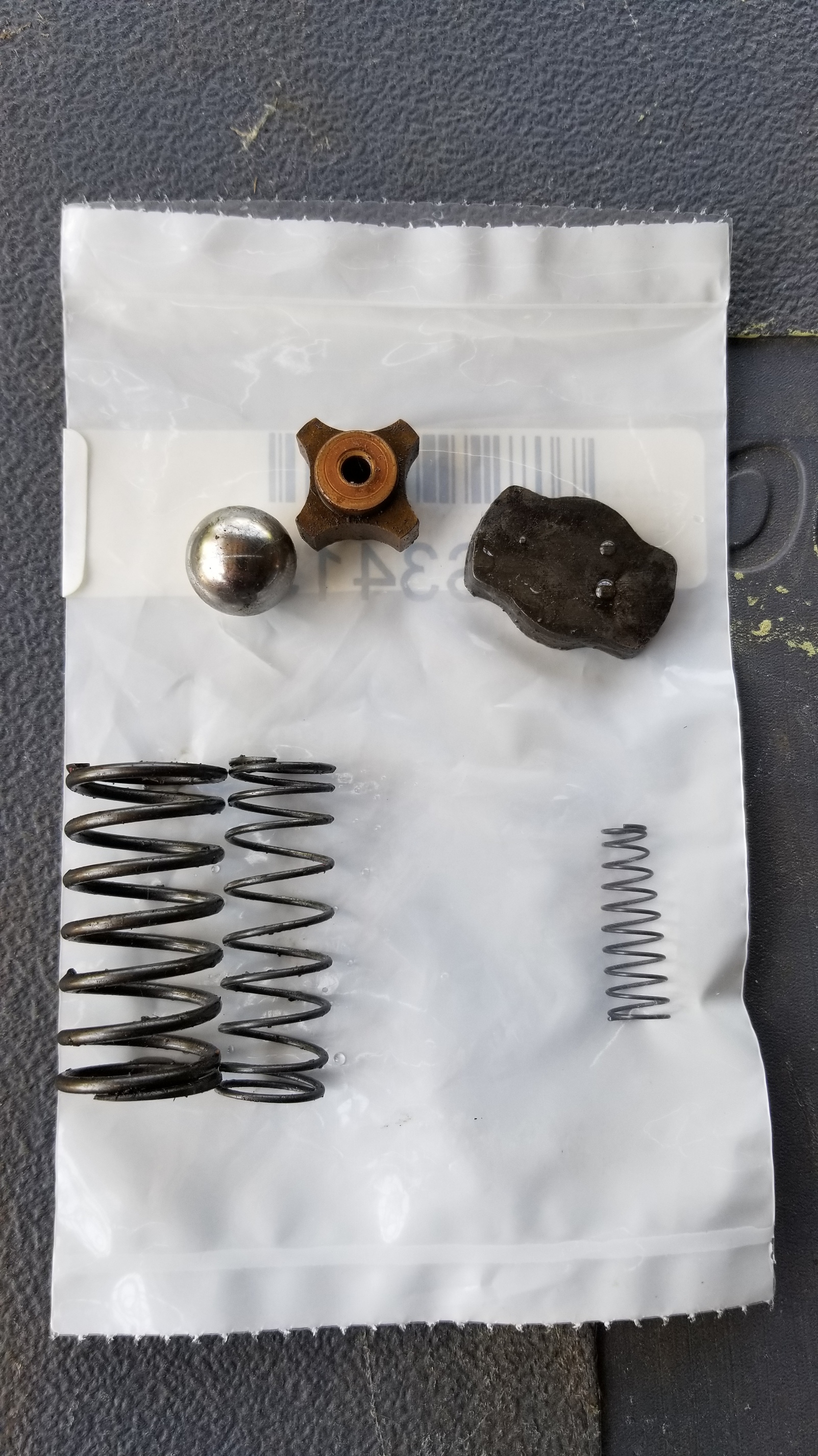

I ordered an oil pump rebuild kit and the oil pressure and thrust springs along with the check ball and other parts under the cover at the front of the cam. My only thought at this point is that I had an oil flow problem. I ordered all the parts from Jensales, Inc. They served me well with the rebuilt kit for my gas 226 in my D17 a few years back. But here is the catch they sent me one of the two springs I ordered for the front of the cam and it is the same oil pressues spring that is in the pump rebuild kit. It is smaller and cone shaped not at all like the old spring that was in the motor. I have a photo of the old parts sitting on top of the bag with the new spring in it. The new spring is all the way to the right in the photo. Which spring is correct?

I'm no expert but have rebuilt a few of these and really don't think the spring on the right would be correct for this application. Also, I doubt that you need to replace the original ball and springs unless the ball has pitting for some reason. Oil pressure really comes from the cam bearings if your pump is good.
Just my thoughts but others on here know a lot more than I do.

Roach thanks I was looking at the pump rebuild kit and it has a check ball that matches that new small spring but there isn't a ball and spring in my old pump that I can see to match it. I sort of got sidetracked with the sleeves not matching up right though. You are probably correct that I can use the old springs and check ball on the cam I just figured those parts where cheap enough I could replace them to be on the safe side.
