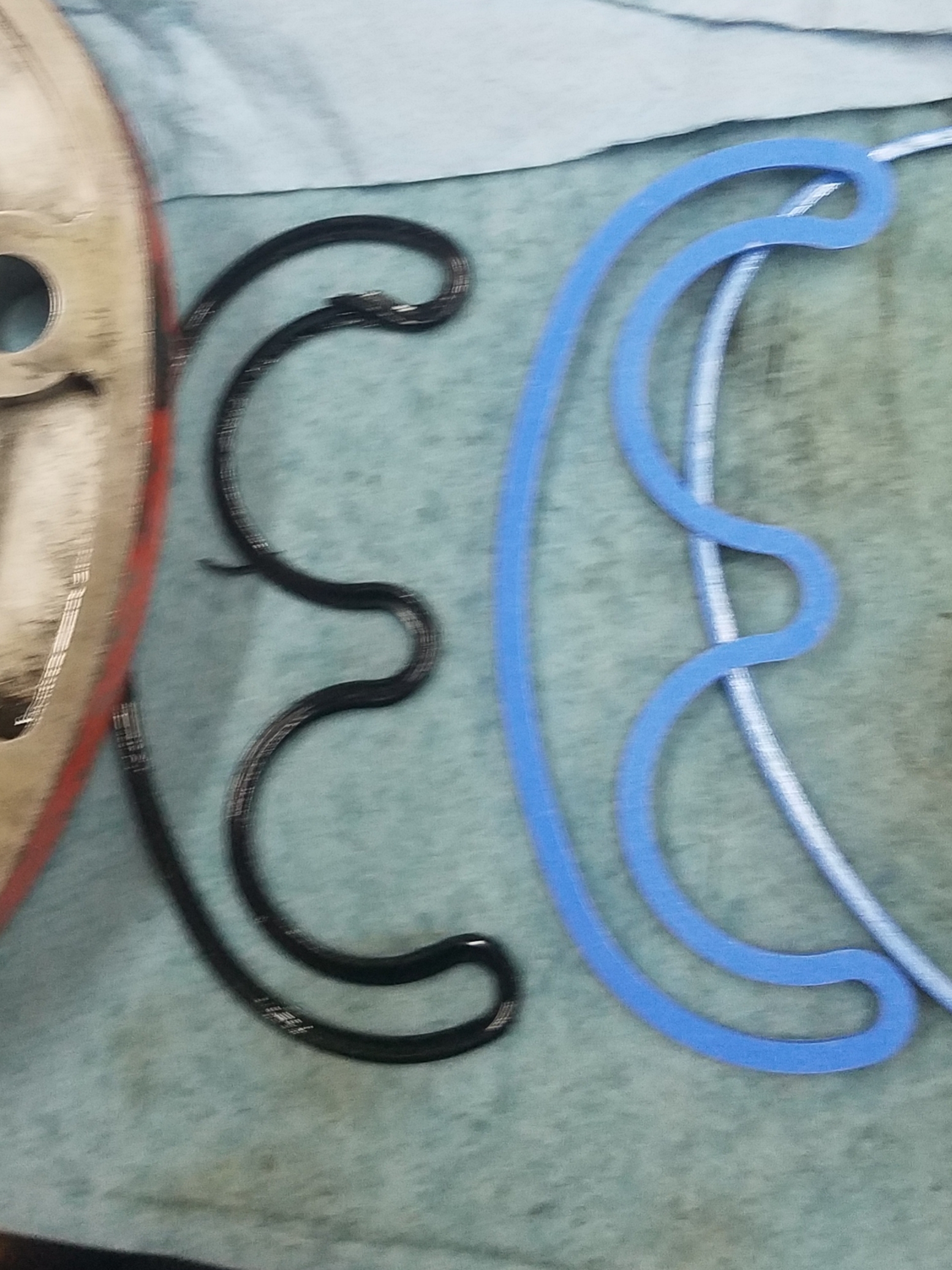

Resealing a pump on our 64 d17, and put new plates and seal kit in it from agco, the pump will not turn freely once the bolts are even snug, it has a lot of resistance.
Is this how they are supposed to be or is something wrong? The plates are the only thing different. It had a new seal kit put in last year and they failed due to the plates having grooves in them from the old seals.

It has rubber and plastic seals that come in the kit I assume the plastic goes in the groove first followed by the rubber going against the plates.

Rubber Goes In First

Post Options Post Options   Thanks (0) Thanks(0)   Quote etcv97 Quote  Post ReplyReply Direct Link To This Post Posted: 22 Jun 2019 at 4:39pm
So you are saying the blue plastic goes against the plates unlike the originals that were rubber with a formed wire?

yes . blue against the plates. the pump will turn hard when together but should turn with pliers

Post Options Post Options   Thanks (0) Thanks(0)   Quote etcv97 Quote  Post ReplyReply Direct Link To This Post Posted: 22 Jun 2019 at 4:55pm
I thought the rubber was to seal it like the old ones how does the plastic seal?

Post Options Post Options   Thanks (0) Thanks(0)   Quote Dave H (NE) Quote  Post ReplyReply Direct Link To This Post Posted: 22 Jun 2019 at 5:11pm
oil pressure from the gears, moves through the hole in the wear plate and pushes the wear plate against the gears making a tight seal. the blue plastic can take the oil pressure to make the seal. the rubber would just blow out. the old seal used the metal to hold the rubber in place, but it wore in to the wear plates.
