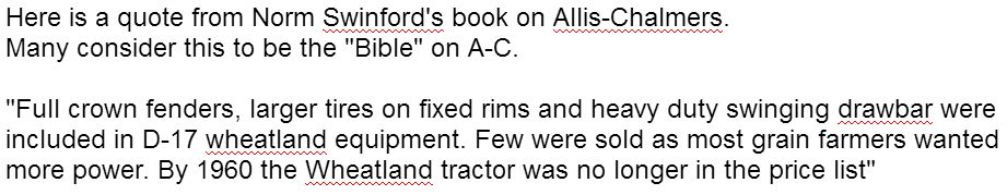

In searching for pictures of D17 markings, I found the D17 Wheatland tractor. It has 18.4 x 26 tires as it's standard tire. Would that mean that the 18.4 x 26, can be used in antique pulling?
Edited by frnkeore - 24 May 2019 at 11:57am

I found this, regarding dating Wheatland.
So, it fits the Antique Class, date criteria.
Edited by frnkeore - 24 May 2019 at 11:58am
