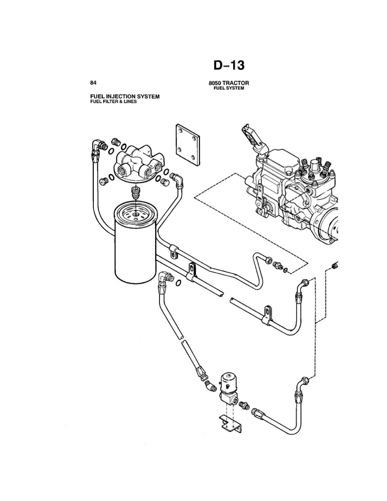

Which hose in the diagram is the one that you guys are talking about? Wondering for myself and for people in the future that may search for this post.

Post Options Post Options   Thanks (0) Thanks(0)   Quote Ron(AB) Quote  Post ReplyReply Direct Link To This Post Posted: 20 Apr 2019 at 5:58pm
The hose with two clamps on it.
