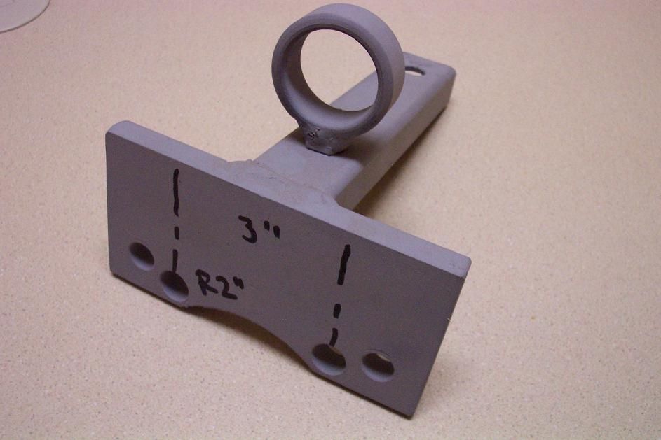

The critical dimension, and procedure ...  (we're looking at the LEFT side here)
I made a lifting bracket that bolts to the final drive and makes the whole assembly balanced when taking it out and putting it back in.  The axle has to be lined up for it to slide together.  If you want the dimensions and/or pic of the bracket , let me know

Lift Bracket;
Drawing;
The plate can be flame-cut.  It can easily be 3/8 thick.
The 1" x 1 1/2" was rectangular tubing; not solid.
