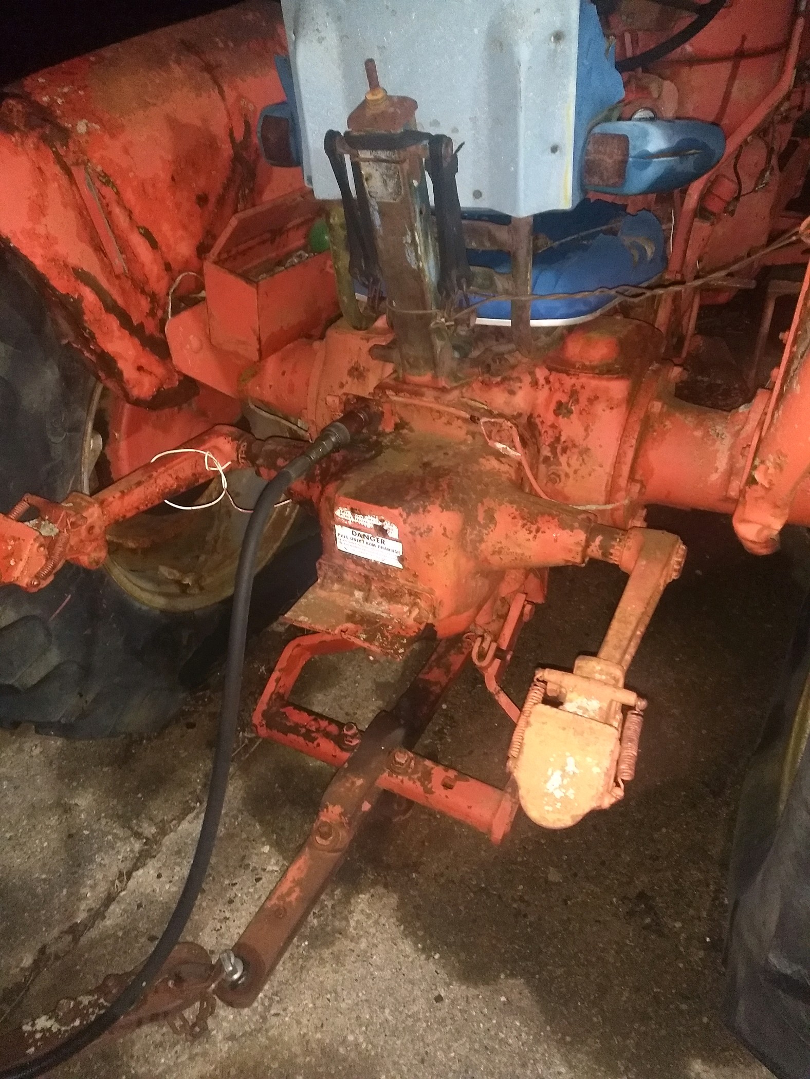

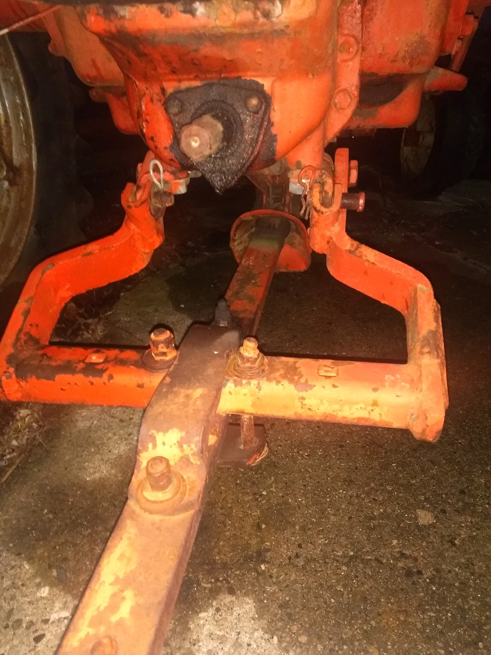

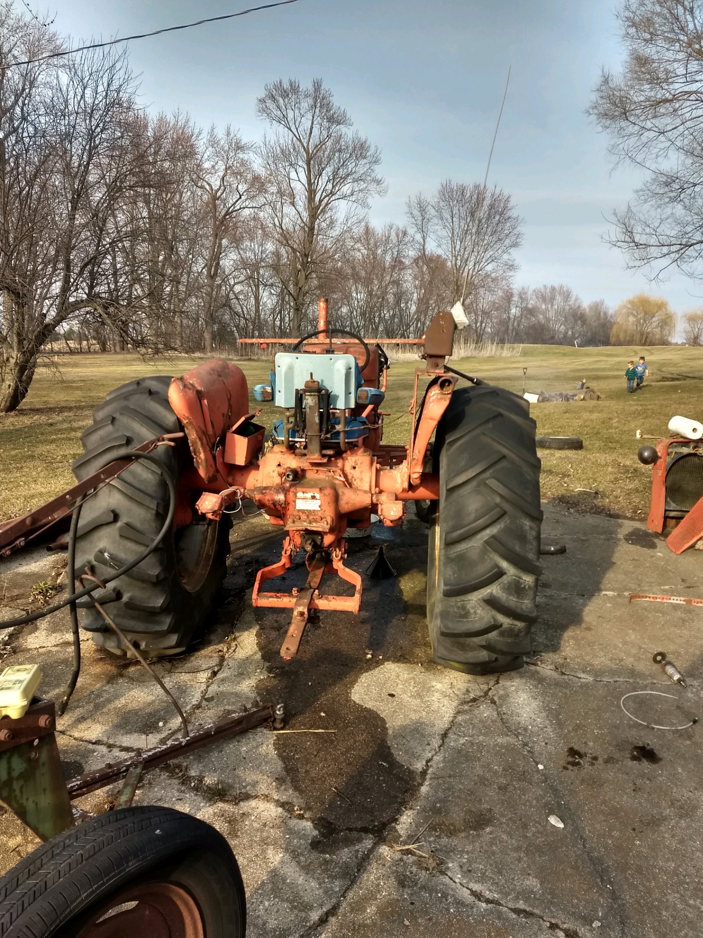

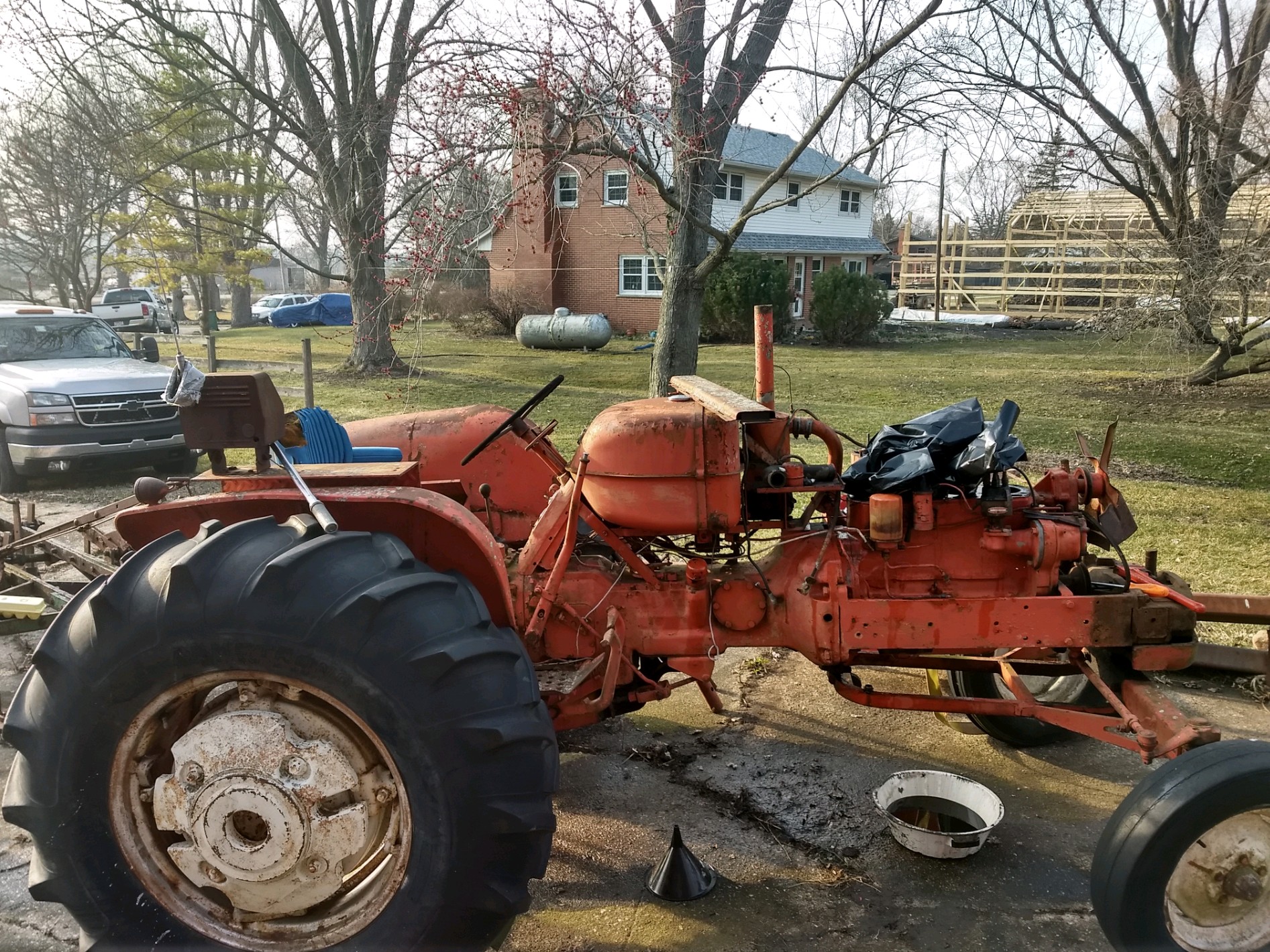

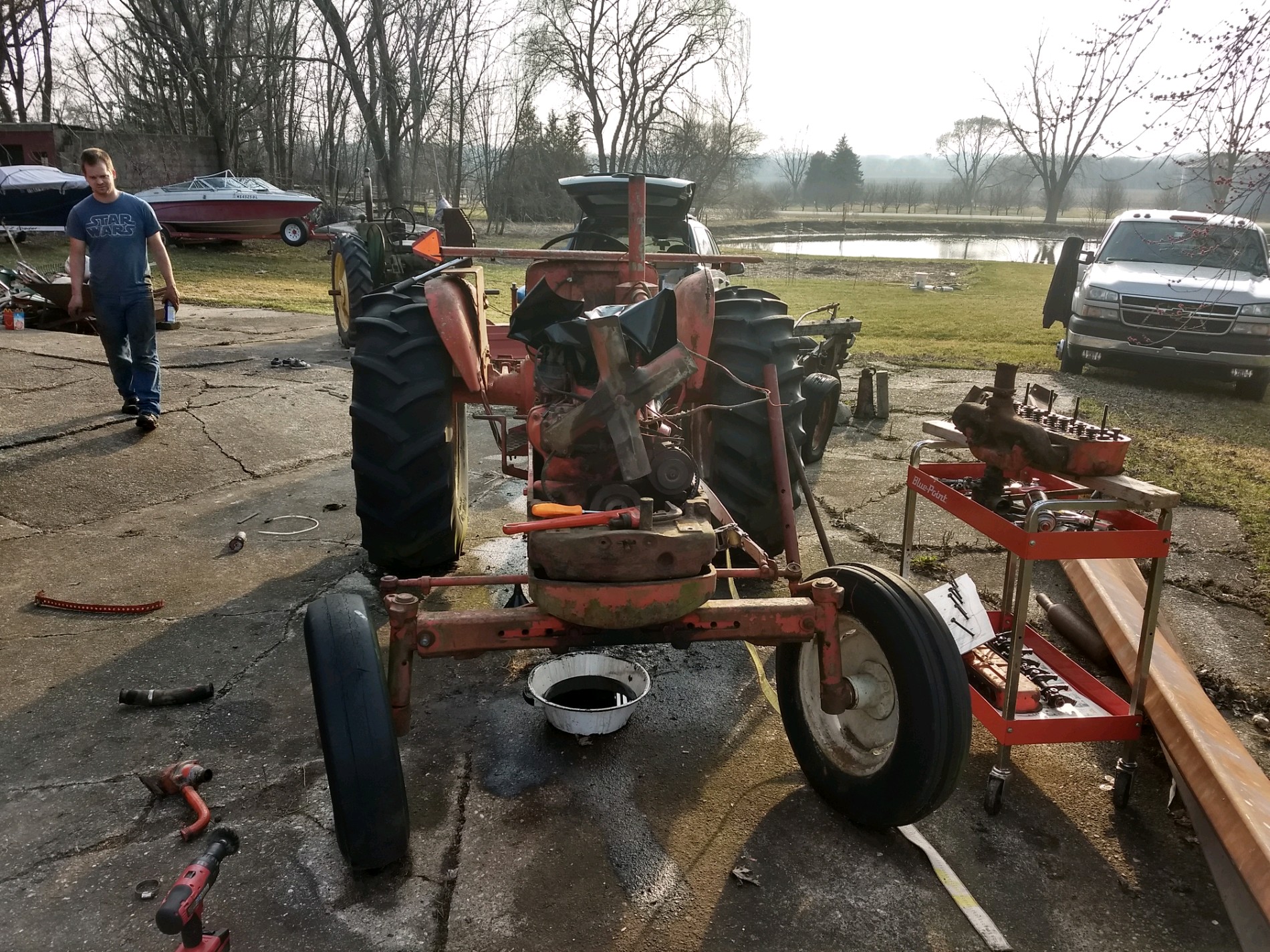

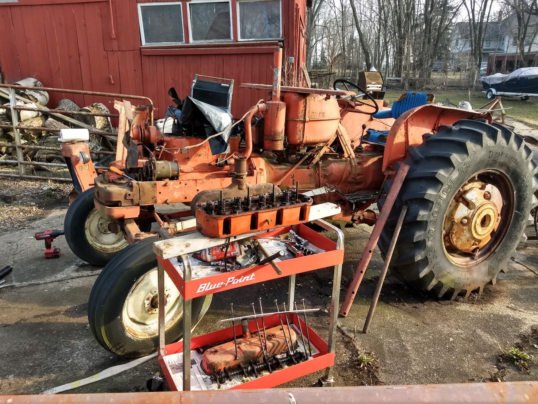

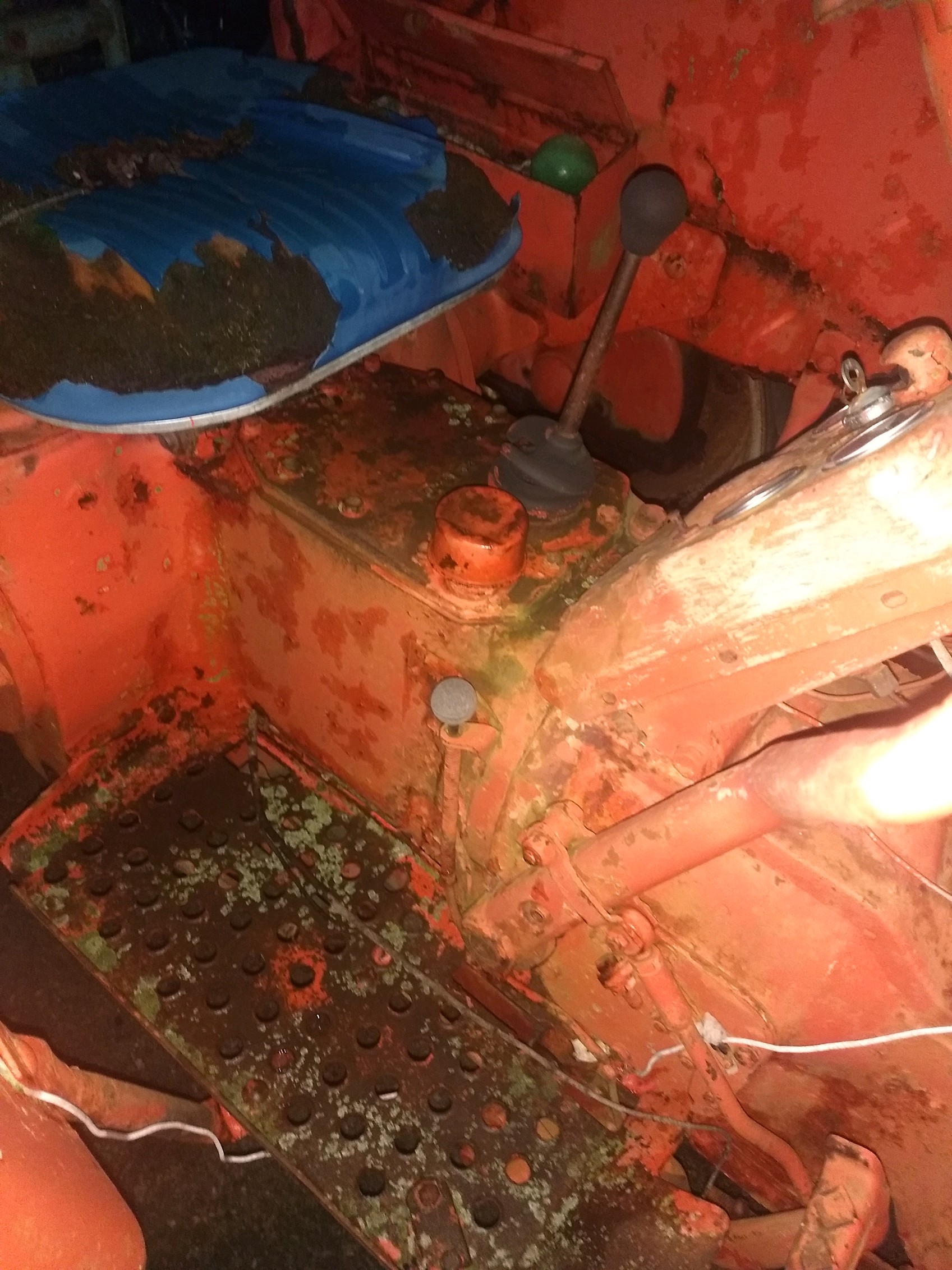

Pictures as promised!
Points: 22804
Post Options Post Options   Thanks (0) Thanks(0)   Quote DrAllis Quote  Post ReplyReply Direct Link To This Post Posted: 06 Apr 2019 at 8:27pm
That seat assembly makes me laugh !!  So, instead of overhauling and repairing the excellent and original suspension, we graft on a piece-o-crap setup like that !! Whoo Hoo !!

Well, Cylinder 4 forward pushrod is bent and even with the head removed, she ain't turning by hand. Gonna take the head to the shop for a fresh up. May try to put it into gear and move it back and forth a bit to see if it'll budge. Otherwise I'll be dropping the pan, unbolting the rods and trying to work them out for a honing... Unless anyone has a better suggestion?

Post Options Post Options   Thanks (0) Thanks(0)   Quote Strokendiesel002 Quote  Post ReplyReply Direct Link To This Post Posted: 06 Apr 2019 at 8:34pm
Dr - yeah, I noticed that it doesn't look like most of the D17's I've seen... Gonna be working on that after I get her up and running
Be very careful.Many connecting rods have been bent this way.

Thank you BA, I most certainly will be gentle, picking back and forth by hand, unless there's a better way?

You could push a sleeve up out of the block turning the crank with stuck pistons and no head on but it's probably what you'll be doing anyway.
