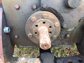

I have a 1974 7050.  I'm trying to figure out if it's a 540/1000 reversible PTO or 1000 only.  Thanks

I looked at my Operator's manual and it says they're 1000RPM only, but in Norm's book it shows that they had the option for 540/1000 also.

That's reversible unbolt it turn it around and bolt it with the other set of holes that is all you have to do. Looks like in the picture you have 540 now, course splines.

Ya, looks like a 540 as is.

Ok, thank you for the quick responses.  I'll do that when I get home this evening.

Use a tap and clean out all the bolt holes that haven't been used in years. Get the bolts TIGHT or you will be sorry. It is a very good system, but the bolts must be TIGHT.

Ok, I will do that.
