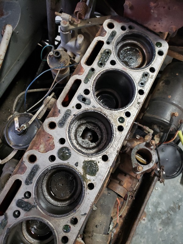

Last saturday I pulled the cylinder head on my A ll combine to find a hole in the top of the piston from a stuck valve. Priced around for a G230. Found engines but some were worse than mine or wanted a bunch of money. Aftermarket rebuild kit was out of the question. Cheapest i found was $1700.
Just ordered piston, piston rings, and rod bearings to replace #3 in the engine. The parts were cheaper from AGCO than aftermarket. Plus now i know ill have the correct compression ratio as the other 5 cylinders. I will have this combine running by Saturday.

Interesting post. Thanks. Did #3's valve just fall into piston? Or were other things happening to cause the piston's hole? Pistons look like they're dished deep. Did Buda also use a "power crater" style piston like AC??

It had a stuck ex valve that found the top of #3 piston. Buda used  power crater pistons in lots of Allis Chalmers combines/tractors.

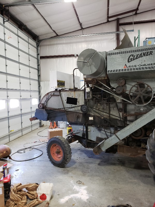

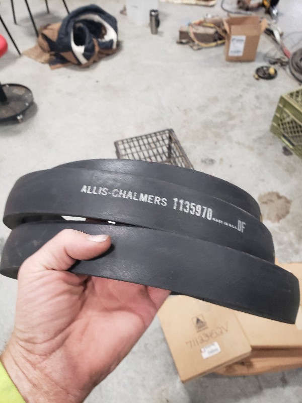

Its like Christmas at my house. New belts. Couple of more gaskets to fix an oil leak. Im going to cut beans this weekend

We hope the rain holds off, Its not looking good here to the north.
Wow that old belt looks good!
