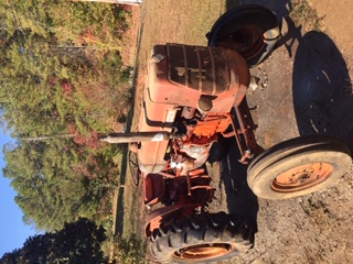

 I haven't got a good photo because the tractors 'work in progress' due to the breakdown. So far a front bearing has been tightened and its been de-greased and cleaned of all the oil and grime preserving it. I hope to have it up and running as soon as I get a new radiator.
This D272 was made in 1959 and came fitted with the optional p3 (3 cylinder diesel engine) supplied by the famous diesel engine company Perkins which was conveniently local to the Allis factory. Its got 3 point linkage and an optional hand clutch for the P.T.O.

Nice little tractor! I can relate to the quirkiness of British Allis tractors. I am in the middle of a restoration of an ED40 with a 4cyl Standards and Ricardo 23c diesel engine. Hope you get it going, would be nice to see! Welcome to the forums....

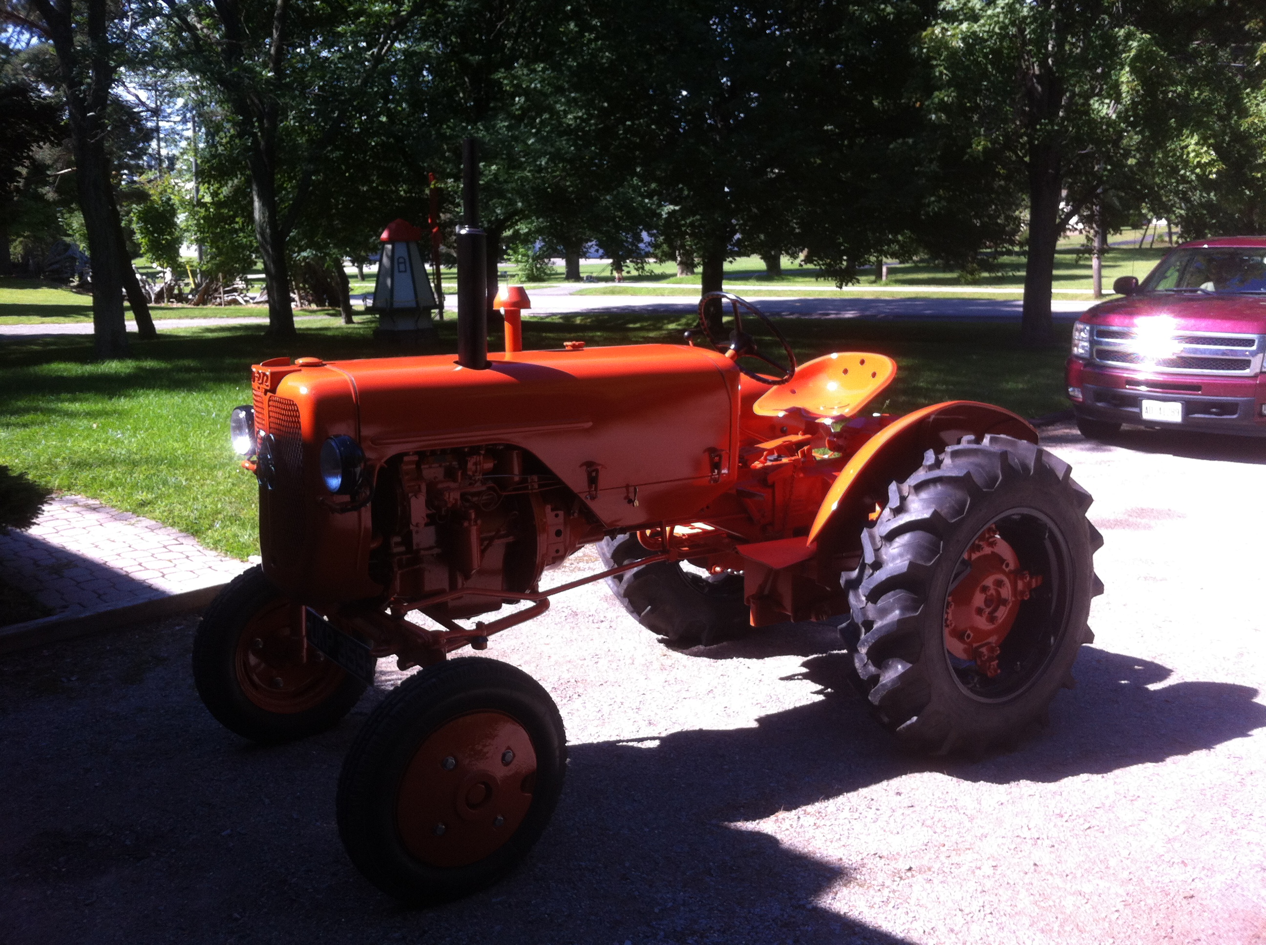

In our collection here in Ontario Canada we have 2 complete D272's. One is fully restored back to 100% original, the second is a good runner and mostly complete. I know we had a third tractor but have taken it down for parts and is on the shelves in pieces and parts.

Good luck with your tractor Mr D272. That last picture is a real head turner!

Your D272 is immaculate! Doesn't have the dents or bodge repairs that mine has, I'm hoping mine will look as good sometime in the future. I have a couple of questions about it, firstly the big one:
- Firstly what's that bracket and chain for? Does it lead to another drop down P.T.O by the drawbar?
- Secondly are the front wheel weights the same as can be found on an Allis Chalmers model B? I'm not looking to get any, just wondering if AC made a separate design for the tractor.
- Thirdly, did you restore the tractor? Is there anything I should look out for?
Also, I'm just interested about your second one. Is it Diesel too or TVO? I'd like to see a picture of it as well- it can't look as bad as the state of my D272!

The D272 was set up with the lower bell for snap coupler attachments as well as the arms for three point hitch, that bell you see the front snap coupler bell and the chain is the release latch mech. All factory.
The front wheel weights are factory D272 weights only, they only fit D272's, very hard to find.
The rear adjustable spin out rims are also very hard to find, the outter rim is similar to that of a CA, but the center cast is D272 only.
My father and I restored this tractor a couple years ago, and I get the second one running for him to bring to a Gathering Of The Orange a few years ago. Both these tractors are the Perkins diesels.

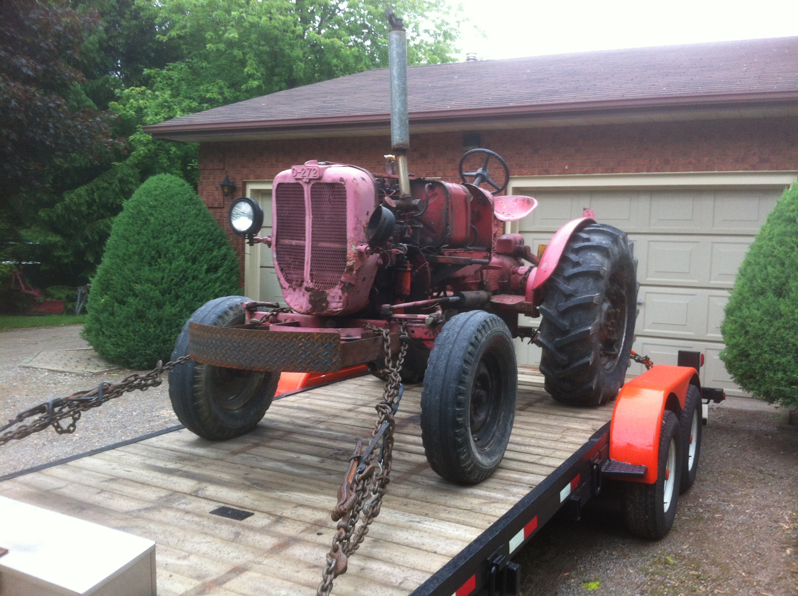

We almost have enough parts left over to put together a third, the hardest part of them is the main cast torque tube, trying to find one not cracked or damaged. The tractors were known to be very rough running and vibrate themselves apart, which they do!!! use lots of lock tight lol

Thanks for posting another pic, there's not many D272 photos out there un-restored. I'd never have guessed the chain was a release for a snap coupler. I think here in the U.K many farmers at the time weren't prepared to pay for fancy expensive extras and snap couplers are a rare sight to see. I always wondered what the point of the lower bell was for on the D272, as my tractor just holds the arms for the three point hitch.
I thought those wheel weights looked different, but I'm no Allis Chalmers expert so I had to ask. I have never seen a pair, its unlikely I will ever find some but I will now be on the look out.
Luckily my tractors torque tube is in relatively good shape. It does have a crack about 1 inch long at the front rim joining the engine. It has been previously welded, but doesn't look like a major problem. Its interesting to hear you say about the torque tube weakness, as I recently heard a local story when talking about my new tractor. Back in the late 50s/early 60s a local farm had a D272. The farm had converted a horse cart to have a drawbar for a tractor. One day the D272 was pulling the cart with a heavy load of potatoes and the driver took the tractor over a small rut at the end of the field. The D272 dropped down a little and with the weight of the horse cart full of potatoes snapped the torque tube and split the tractor in half!
