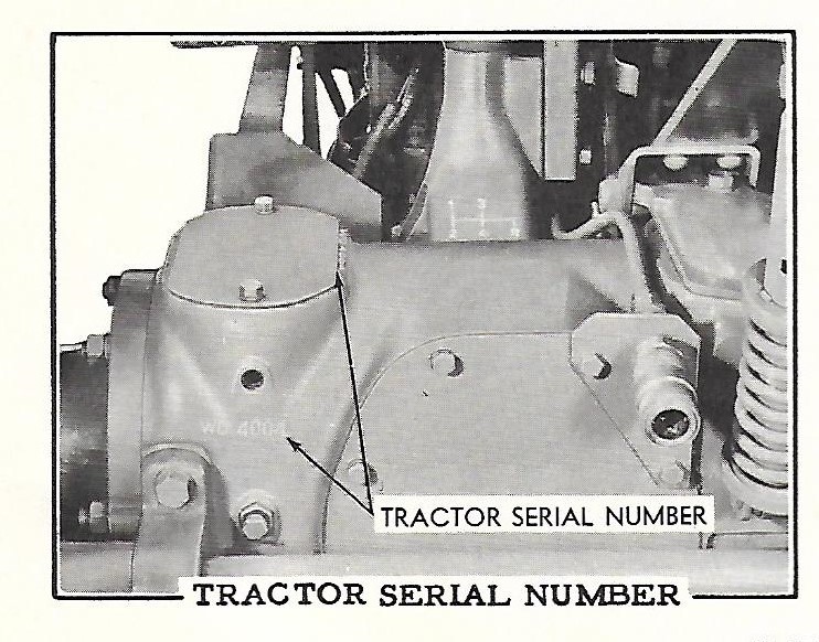

I inherited my Grandfathers Allis Chalmers WD and am looking for the Serial number. I know it is supposed to be on the top Left Brake differential, but I am still struggling to find it. Can anyone give a detailed description or have a picture of where I should look?

Only the older ones have it there. The newer ones have stamped on the rear differential housing

I looked on the Rear Differential and it is not there. My Dad and I have been all over that tractor and can not find anything close to a Serial Number.

looking at back of tractor' to left hand side back side of brake cover' on casting' should be wd- number;

Just above the lift arm shaft on the left side very close to the setscrew with the SQUARE head on it.

See picture

I should also mention I have one that is smooth with no number I guess the housing was replaced at some time.

Also to mention that I have one (1950 WD) that has had a later 1952? WD differential housing replaced. About anything can happen out there in the real world!
