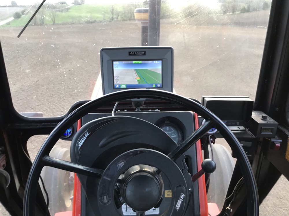

I’ve got quite a bit going on in here, but might give you some ideas.

Post Options Post Options   Thanks (0) Thanks(0)   Quote exSW Quote  Post ReplyReply Direct Link To This Post Posted: 22 Apr 2019 at 11:27am
Nice. Being able to adapt technology like mapping and gps speed to these old tractors really interests me. The monitor I'm using is a simple beep and tie round baler unit. The location off the control tower means I can swivel the seat,drop the PS to neutral(if I want),tie,open the gate,back into gear,leave the bale and close the gate with right hand only.
I due plan on seeding some new alfalfa stands this year so application rate,speed and location monitoring tech is on the plate. I'm thinking the apps for and android based device is out there.
