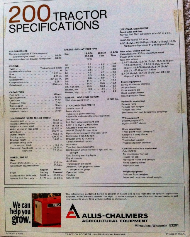

The 200 factory cab is ROPS rated I do believe.
Not sure if a year-round would be.

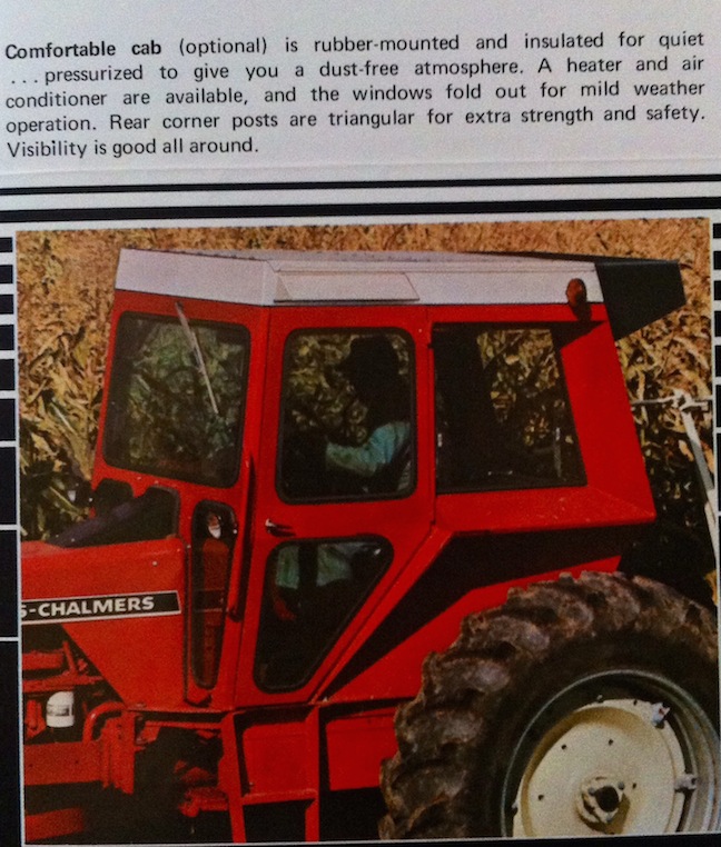

A factory (LaPorte built) AC 200 cab was quite roomy and pretty darn quiet. Now, after 40+ years, I'm sure the sound deadening insulation isn't like it used to be.  Compared to a Hiniker or Year-a-Round cab it was very nice.

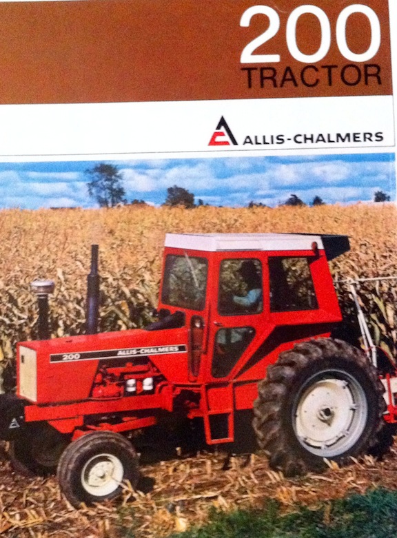

Here are 3 photos from a May 1973 AC 200 sales brochure. First photo shows tractor chopping corn. Second photo talks about cab's rubber mounts (was a huge improvement to isolate operator from incoming engine/rear-end frame noises) & other comforts. Third photo list specifications . The optional equipment is listed on the right side with cab (ROPS) info in it's lower right corner.
I feel the 200's factory cab with it's door shape and front glass with lower viewing windows may have been the predecessor to the black belly 7000 series?? Anyone on this forum that used to work at AC factory want to weigh in with their insights?
