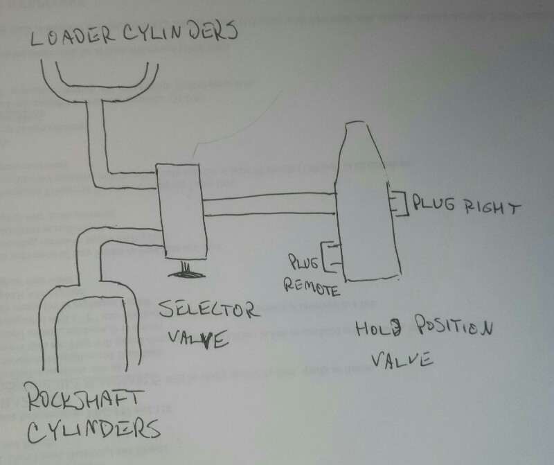

Hey all. I'm thinking I'd like to put in a selector valve so I can control either the loader or the rockshaft at one time, without them ever fighting each other. Am I barking up the right tree with capping two outputs of the hold position valve like so?
Points: 22307
Post Options Post Options   Thanks (0) Thanks(0)   Quote DrAllis Quote  Post ReplyReply Direct Link To This Post Posted: 28 Apr 2018 at 9:10pm
You want your selector valve connected to either of the other two ports, not the one you have chosen. If you do it your way, you will not have "HOLD" position.

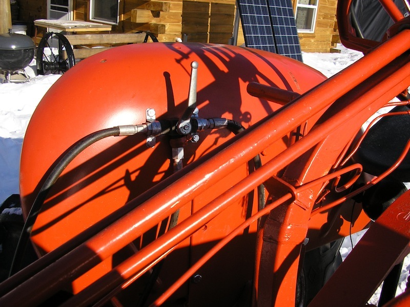

This is how I did mine. I like it so I can change it from the sear. Just use a valve that is rated for the high pressure. uploads/375/P1010112.JPG

Post Options Post Options   Thanks (0) Thanks(0)   Quote sadmyentist Quote  Post ReplyReply Direct Link To This Post Posted: 29 Apr 2018 at 4:26pm
Thanks mdm, I was thinking of something similar, though my idea was to put the selector in front of the battery & make a linkage rod to switch it from the seat. Probably off to the right of the starter pull rod

Sad
That's what I did on a WD. Mounted the Diverter Valve on a flat plate and bolted the plate to the R/H side frame rail. Installed a push / pull rod to the valve.
I think it was a B starter rod.

So, on the hold position valve... Am I interpreting this correctly that I need to plumb this off of a rock shaft port and not the remote port?
Points: 22307
Post Options Post Options   Thanks (0) Thanks(0)   Quote DrAllis Quote  Post ReplyReply Direct Link To This Post Posted: 30 Apr 2018 at 7:20am
Two of the three ports are under the control of the HOLD valve. The one you have chosen is not, so HOLD will not work. It has either raise or lower.

Post Options Post Options   Thanks (0) Thanks(0)   Quote sadmyentist Quote  Post ReplyReply Direct Link To This Post Posted: 30 Apr 2018 at 8:18am
Oh, I see where I'm off. I have the remote and rockshaft ports reversed on my drawing. The remote port should be in front, opposite the left rockshaft port.
Come to think of it though, That limitation would be important to anyone planning to add a loader to a wd or wd45. These old loaders off and look like they should plug right into the remote, but this valve won't run it off the remote properly.
