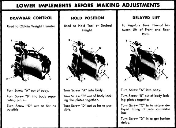

Post Options Post Options   Thanks (0) Thanks(0)   Quote DrAllis Quote  Post ReplyReply Direct Link To This Post Posted: 23 Apr 2018 at 10:31am
You need to utilize the decal on the side of the battery box or get an Owners manual. There are 3 settings for the hydraulic pump and yours isn't set up for "HOLD" position control.

Post Options Post Options   Thanks (1) Thanks(1)   Quote Stan IL&TN Quote  Post ReplyReply Direct Link To This Post Posted: 23 Apr 2018 at 12:30pm
1957 WD45 dad's first AC

So I disconnected each linkage one-by-one to isolate everything.  Linkages had a small amount of play, but were otherwise in good working order.  I took the hold position valve linkage off so I could isolate the pump.  Lever on pump moved well and I finally felt that neutral detent--it was plain as day.  I hooked everything back up and I can't feel the detent at the operating lever.  To even move that lever I have to bump it or really yank on it.  I went down and separated the plates using screw "B".  With only one plate on, the operator lever is nice and smooth and neutral is readily felt (but obviously it doesn't hold position).  But, once screwed in "B" and locked the plates together,  the operator lever is difficult to move, jerky, and I can't feel the neutral detent.  Rams still creep up and down.  I'm thinking the issue is with the hold valve?  It shouldn't cause jerky/binding operator lever operation right?
