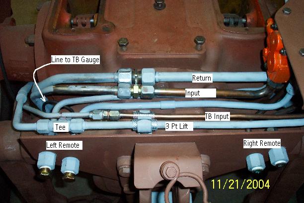

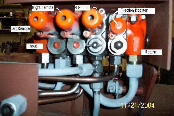

DSeries4, do you happen to have any photos of how the hydraulic lines are tied into the pump, and also of the control panel?

Nothing different coming from the pump.  It is just another section that gets added to the valve body.

DSeries4, thanks for the pics. This is what I would like my final setup to be where the two inside levers are for hydraulics and the outside lever is for the three point. Can you, or anyone else, confirm that there is no additional piping to the hydraulic pump for this setup? My current understanding is that a person would just have to add another valve body and plumb lines to the rear of the tractor with nothing additional required from the hydraulic pump to the valve bodies.

Your understanding is correct.

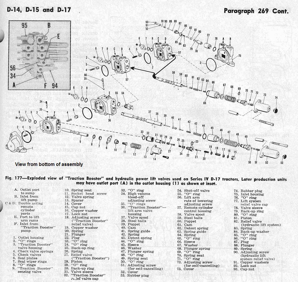

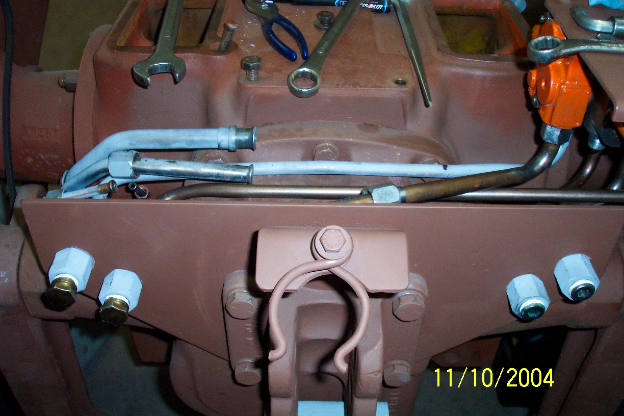

I added a remote valve to the stack on my D17sIV. It came from a 180.
If you go this route, you'll need the longer tie-bolts that hold the stack together as the valves are 1 1/2" thick.  These should be factory; DO NOT use Redi-Rod or All-Thread.  You'll also need the outlet tubes/fittings that connect to the bottom side of the new valve.
These are routed to the back plate for the couplings.  The existing tubes on mine had bad leather rings and I had to make some backing rings to take up the space.
When disassembling, have a clean area and pay close attention to the small valves & springs in between the valve bodies (items 4 & 5) below....you don't want to have a Roger Welsh moment.  Note; "View from bottom of assembly"

Gatz has provided great pictures and information for you.  There is definitely no change in piping coming from the pump.

Yes, there is one change of lines. The short unpainted input line behind the seat is 1 1/2" shorter. That could easily be replaced with a hose. The two "new" lines to the left outlets could also be hoses instead of steel lines.  My feeling on this matter is not everybody is talented enough to disassemble the original valve stack and add on an extra valve. When doing so, that is the best time to just reseal the whole stack and have it leak free for the next 30 or 40 years. I'd suggest just purchasing the open center "power beyond" type dual spool valve and mount it above the hand clutch area. This would be a dedicated loader only valve and leave the tractor valves just as they are. Mounting it to the right side leaves your left hand free to shift gears. This is what I'd advise to someone who might not be comfortable with the disassembly of the original tractor valve stack.
Yup, that is what we did on our IV !!

On the other hand, I will disagree with the good Dr, however .....there's really not enough room ahead of that mounting plate to get hoses and the necessary end fittings in there.
