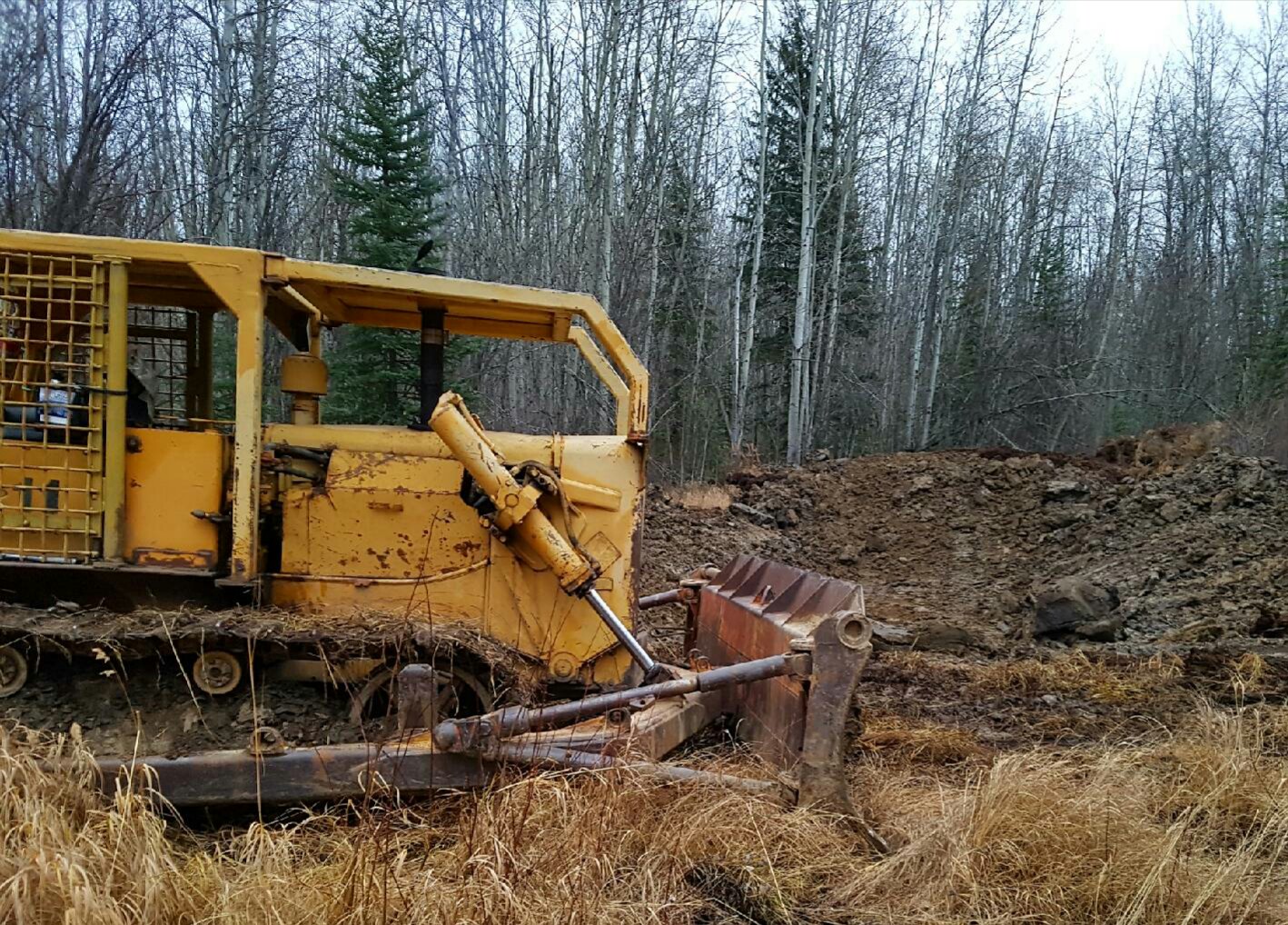

Post Options Post Options   Thanks (0) Thanks(0)   Quote Homesteader64 Quote  Post ReplyReply Direct Link To This Post Posted: 05 Dec 2017 at 3:16pm
This is old Allis... digging a pond for his neighbour....me.
