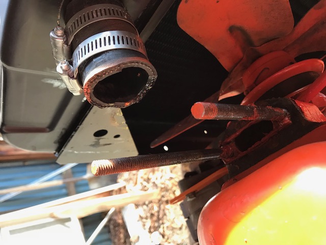

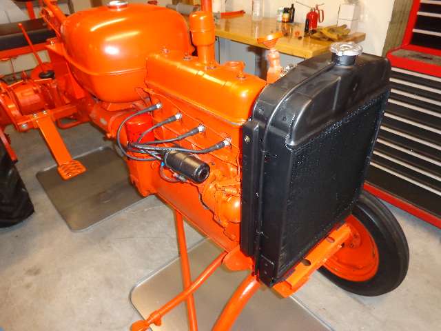

I put the new radiator I got from JimD on the B today. I had a few problems. First, is anyone familiar with those radiator mounting pads? They're little square pieces of rubber about 1/4 inch thick that the radiator sits on. They seemed to make the radiator sit to high. The radiator shell pressed down on top of the over flow tube, no clearance at all. I decided not to use them, even the hoses seemed to line up better without them. These things come from Steiner's and other places and I just wonder if they were ever standard equipment in the first place.
Second, when I turned the engine over, the fan hit the radiator. I took the radiator back off and bent the blades back a bit. This seemed to work, but I hope I didn't mess up the proper air flow.
Last I was worried about the tractor getting to hot, but that wasn't the case. The first number on the gauge is 120, but after running and driving the tractor around about 30 minutes the needle didn't even get that high. Again, this gauge came from Steiner's so I'm not sure how accurate it is. I know it seemed to work the day the tractor over heated, it went all the way in the red then. This may not even be a problem, the cooler the better right? Most things run hotter than 120 I thought, the D10 usually sits on 190 mostly, but its gauge is different than this one.

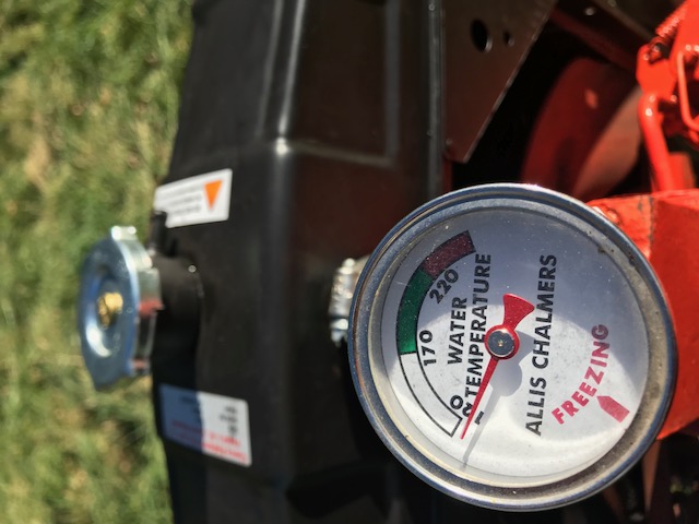

easy way to test the gauge..
gently boil up a pot of water, with the wife's candy thermometer in it and your tractor thermometer,
With 'Troy, D-14 #1', the needle goes up to 210 then drops down to 180...all day long. Don't know why and that's after I cleaned the rad, new hose, new and checked stat AND it don't smell 'hot' either AND it always does it. I'll check once Shameless' machine spits white here....

120 hints that the thermostat is bad, has absorbed water in the expansion chamber. I've had that happen on other engines.
http://geraldj.networkiowa.com/Trees/Allis-Chalmers-G-B-C-CA-Service.pdf
says the thermostat for gas engines opens at 135 and for low octane fuel opens at 165.
135 probably is appropriate for alcohol antifreeze but with modern permanent antifreeze, 180 is more appropriate. Getting above 135 would evaporate alcohol, but not permanent antifreeze. Permanent antifreeze raises the boiling temperature of the coolant mix as does a pressurized cooling system. Many an alcohol antifreeze engine has used a 160 or 165 degree thermostat.
120 or 135 isn't going to boil water condensate out of the crankcase oil and water in the oil is hard on bearings, making a shorted battery where the insert is separated from the crankshaft by water and that eats away at the copper or silver of the bearing insert.
180 is a compromise in engine temperature between boiling the coolant and improving engine efficiency. The cooler the cylinder walls and head, the more heat is wasted from combustion hurting engine efficiency. Running much hotter would give better fuel efficiency, but oils to lubricate the cylinder don't do well much hotter. 120 really hurts engine efficiency.

Gary, no the temp just rose to were is at and held. I drove the tractor up and down a steep hill at high throttle for about 30 minutes and it never got any hotter. Everything seemed fine, I just assumed the normal operating temp would be somewhere in the white area on the gauge. The tractor doesn't have shutters, and I was even running it without any sheet metal on it. That could have made it run a little cooler I guess. It's certainly better than over heating, but I was just wondering if running it cool could be causing any harm?

I think I have the same temp gauge.  Mine gets into the green and stays there, but takes 15 or more minutes to get there.  It is northern Indiana and around 30 degrees in the morning when I am usually running it and I don't have shutters.  I haven't had a chance to run it in warm temps yet and when my Dad had this B, the gauge was messed up and not working (why I got the new one).

Rance a cold running engine will wear the cylinders at a faster rate. Believe it or not the hotter you can run them without boiling they will not only be more efficient but last longer. I think testing how accurate your gauge is, is the best idea to start with. I've heard complaints about the gauges made in China, but don't know myself.

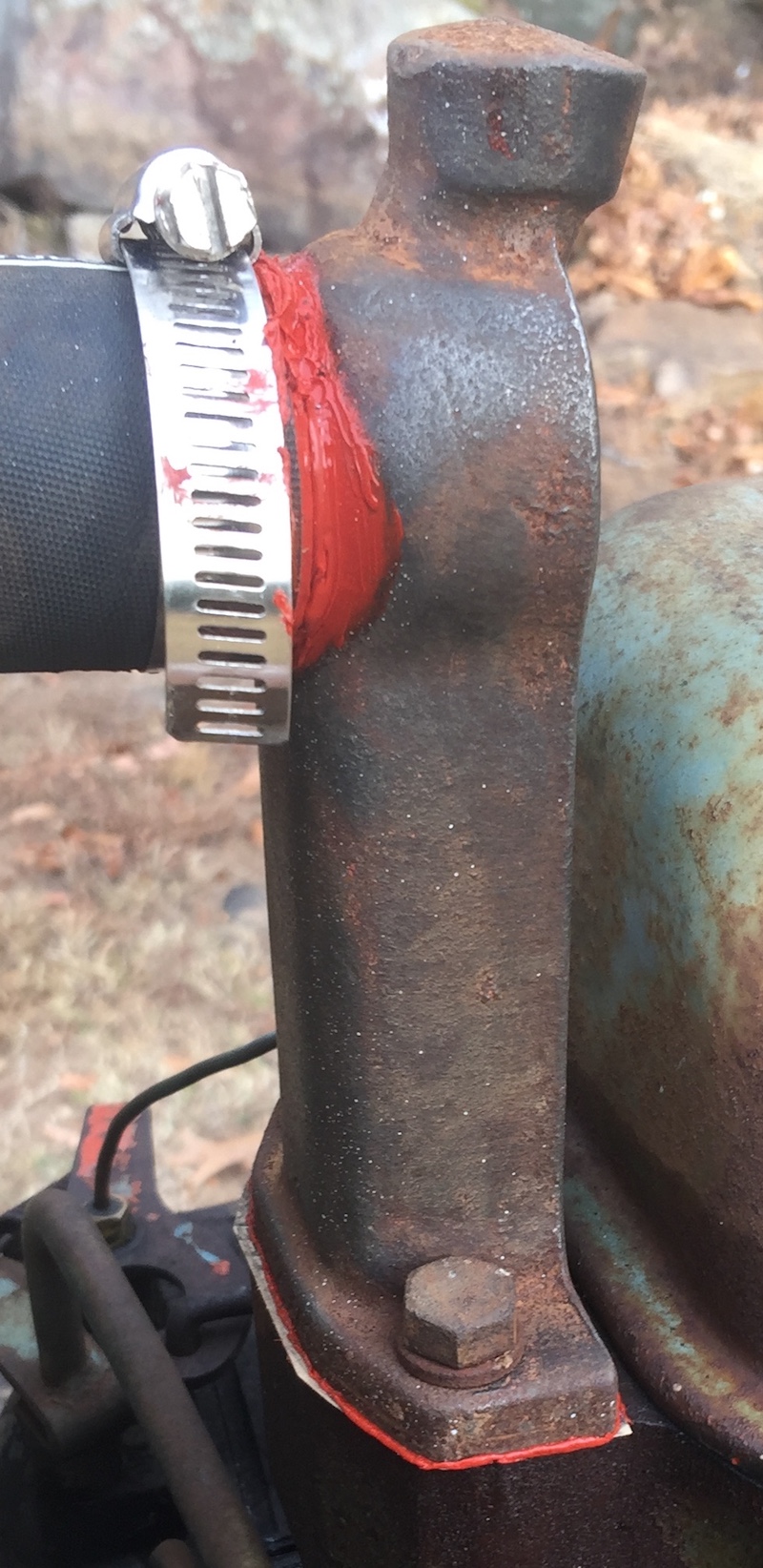

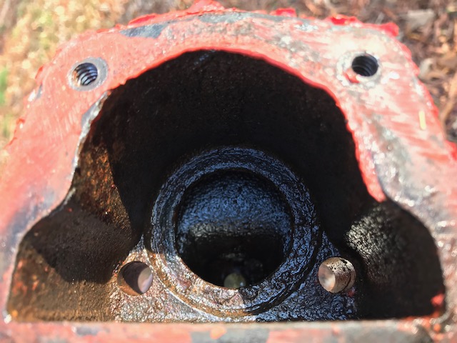

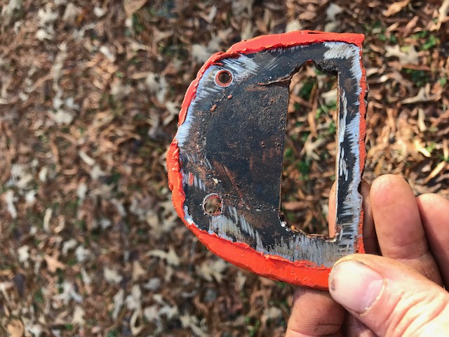

I tried to put a new thermostat in the B today. I ran into some problems due to some previous jerry rigging. First of all, there wasn't a thermostat in it. I guess that explains why it was running cool. I got a few questions, but first I want to apologize for the photos. They are sideways, I don't know why they show up like this, nor can I figure out a way to fix it. It was either post them like this or use photo bucket, and I didn't want to deal with that.
First I believe the housing should be held on with 2 long bolts. Someone used all-thread rod(one 2 inch longer than the other)and 2 nuts at the top. This is minor of coarse, but the rods seemed tight. I hope the holes aren't striped out and they JB welded them in.
Next this plate was between the housing and head. It's obviously home made, but necessary, without it there would be a big opening under the housing.
I think this is not the correct thermostat housing for this tractor. The recess for the thermostat is at the top, but I can't understand what holds it up there. Most thermostats I've installed the recess was in the bottom and they just sat in.

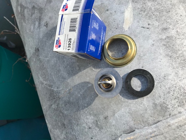

This is the thermostat I got at the part store. It's supposed to be for a B. It has the thermostat, a thick rubber washer, and a brass ring. The brass ring won't even go inside the housing. Since there was nothing in the housing, I have nothing to compare. I'm not sure if I got the right stuff or not, nor how it goes back in.
I believe someone put a different housing on this tractor and made that plate so it would work. I can put it back together the way it was, but I'm not sure if it is possible to install a thermostat with this setup. Any advice is welcome, and I hope y'all can make out my pics. Thanks Ranse.

The housing on my 38 doesn’t look anything like that, and two 1.25” long x 5/16” diameter (?) bolts with lock washers afix it to the head. Mine is a match for the area on the head where it bolts down and doesn’t overhang toward the radiator/fan like that. I discovered that my tractor does not have a thermostat either yesterday when I was halfway flushing it prior to getting it to run. Unless the thermostat fits in the hose somehow I cannot fathom how one would be installed.

The gasket, thermostat, and spring are held up in the housing by the adapter plate. The parts book shows this. Your are missing the spring.

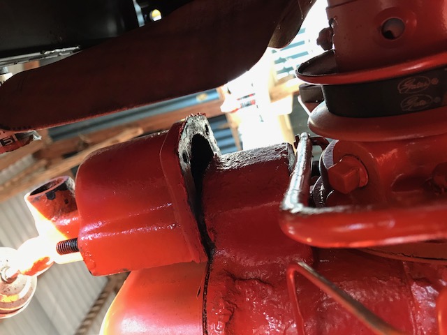

What about my 38? My housing is a tower looking thing with a squarish opening that matches the head outlet. The base is a match for the mounting point and doesn’t widen out. In the video I shot yesterday of my first run after the mag was installed, at the 20 second mark, one can see mine. It looks nothing like this. The water temp gauge hole isn’t drilled.

Theropod, yours does appear to be different. I don't have a parts book, but I have a service manual. It's the same book Gerald has a link to above. It shows a housing very similar to mine, but it doesn't appear to hang over the mounting area like mine. It does not show what's inside. That's what I need to see, I may be missing more than just a spring.

As I recall, the thermostat in Ford 9N, 2N, and 8N did mount inside the upper radiator hose that was straight. If the hose size was right it would be an easy addition to an AC tractor.
Apple products take pictures at a couple orientations and include a tag in the digital picture for which way was down when the picture was taken and apple devices and computers understand that and display the picture bottom down. Windoze PCs don't know that and so display the pictures on their sides much of the time. GIMP is a PC program (windoze and linux) that does notice the rotation and the flag and offers to correct the picture orientation as soon as the picture is loaded. Photo shop may have that capability, but I've never used it.
Gerald J.

You are missing the 2 inch wide spring that holds the thermostat at the top.
The thermostat Steiner sells is the same one as the 9N, but it comes with a gasket for the Ford only, throw the gasket away. Buy the spring separately if you have the thermostat. Here is what you need:

OK, here is what is supposed to be the thermostat housing on my B. I have not seen one anywhere that matches mine. I don't see how a thermostat could fit in this at all. It would have to be placed inside the upper hose somehow, and I don't have a clue how that would work.

I agree, that's totally unlike mine. Mine has a housing for a thermostat, but no thermostat installed. I could put one in, but I just use the shutters.

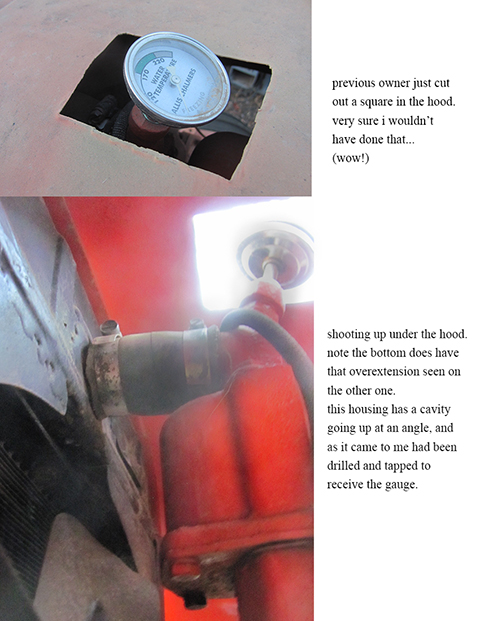

I suppose that is what I’ll have to do too, but my shutters are long gone. I’m thinking a canvas shroud like trucks use up north in winter might work. Trouble is my B doesn’t even have a place for a temperature gauge. Perhaps putting a gauge where the little block drain is would work. Not sure about the thread pattern there, or how I would drain the block if I fill that hole. There is not a lot of room behind the carb! Maybe I should drill out that odd not-a-thermostat housing and tap it for a gauge. I sure don’t want to bake the engine after all the work I have put into bringing it back to life.

Maybe drill and tap a hole in the top of that cast iron housing?

yeah, yeah these pictures are horrible.  will replace them them tomorrow with the hood off and in the light.  but meantime, here's how my 41 B arrived to me - same housing as Ranse's - and I am eager to see what his hood looks like.
sure hope not like mine - he must have used one of those old hook-type canopeners to cut the hole.
(deleted pix)
A hole saw would have done that job so easily.
