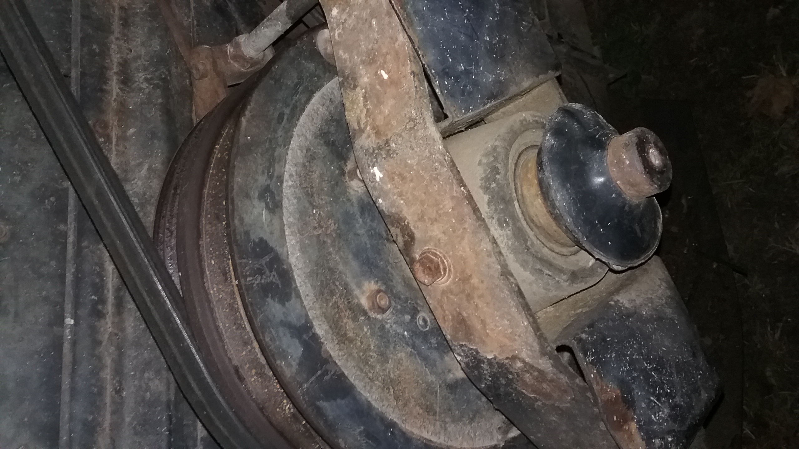

I think i can get the variable speed pulley to work, but the lower pulley (on the transmission) does seem to react to the upper pulley.   Slow the upper pulley down and belt gets loose
Post Options Post Options   Thanks (0) Thanks(0)   Quote shameless dude Quote  Post ReplyReply Direct Link To This Post Posted: 08 Nov 2017 at 8:42pm
belt is supposed to get loose when you slow it up. should be tight when you speed it up. appears your pulley is starting to wear groves at the guide pins. watch that really close. you don't want to have that hub behind those pulleys break....I mean YOU REALLY DON"T! take the grease zerks out and dig the old grease/dirt out as much as you can and replace the zerks for the grease. the upper pulley in hyd moved, the lower pulley moves in and out by way of the belt. there's a big spring inside the lower hub to keep tension.

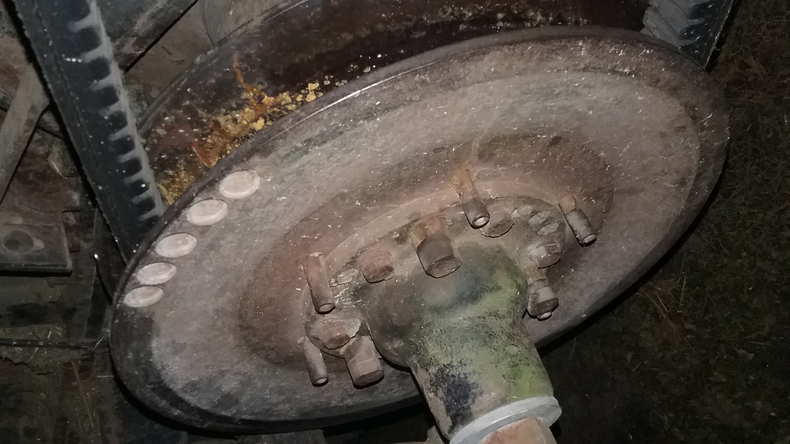

I understand that it loosens up with slowing down. As one pulley opens up the belt gets looser. But isn't the second pulley supposed to take up the slack by using the spring inside?   Right now it doesn't do anything and only looks like its moving in and out a miniscule amount.
I noticed that the pegs were getting some grooves wore on them. How do I go about rebuilding that set of pulleys after season?
Points: 22190
Post Options Post Options   Thanks (0) Thanks(0)   Quote DrAllis Quote  Post ReplyReply Direct Link To This Post Posted: 09 Nov 2017 at 8:40am
The spring on the lower sheaves can't squeeze them back together due to lack of GREASE and now the lower inner sheave is stuck !!    Diesel fuel in a grease gun with the belt removed and a big hammer might get it to slam shut....maybe. Twice a day 2-3 pumps of grease. Did I mention twice a day ???

Drallis, the inner half is the one that actually moves, the outer one is stationary? So if I take off the big nut on the outer half I can remove it and then free up in the inner half?
Points: 22190
Post Options Post Options   Thanks (0) Thanks(0)   Quote DrAllis Quote  Post ReplyReply Direct Link To This Post Posted: 09 Nov 2017 at 10:06am
The outer one is on a tapered hub and won't just fall off on it's own. If you remove the outer and the inner is stuck under spring pressure and suddenly lets go, there's nothing to stop it.  I would remove the belt (or get it out of the lower sheaves) and pump diesel fuel  into the inner hub and try and rotate the sheave while pounding on the backside with a big hammer to see if it won't pop loose on its own. That's what I'd do. You do what ever you want.
