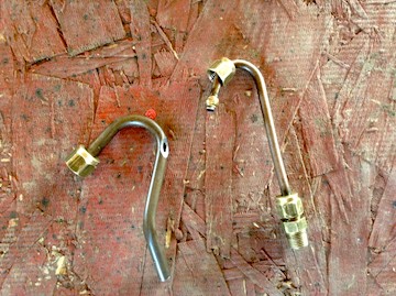

UPDATE: We got another look under the valve cover today and found a couple notable items based on a tip from this forum. The ferrel line closest to the cab was loose and it is apparent that the threads had been crossed (possible prior engine work). Also, the return ferrel at the front of the engine was touching a valve spring and had a large hole worn into the side of it. I tried to upload an image but unsuccessful. I hope I have luck finding these parts. The plan is to replace, re-assemble and run the tractor through harvest and monitor the oil usage. If I'm lucky, this was the cause of the tractors extreme oil usage and I just dodged a major overhaul bill which means this forum has saved me a bundle.

A fellow forum member is uploading the picture for me, and I should clarify my terminology that the ferrel line is actually the oil line that runs between the ferrels (metal caps that secure the line).

Dans 7080 View Drop Down
Joined: 05 Feb 2010
Points: 1146
Post Options Post Options   Thanks (0) Thanks(0)   Quote Dans 7080 Quote  Post ReplyReply Direct Link To This Post Posted: 13 Sep 2017 at 5:13pm
Line on the left would be your problem.
When someone tells you Nothings Impossible, Tell them to slam a revolving door
Points: 22140
Post Options Post Options   Thanks (0) Thanks(0)   Quote DrAllis Quote  Post ReplyReply Direct Link To This Post Posted: 14 Sep 2017 at 7:19am
The line on the left is the front drain line and is 2 feet away from the breather hose, and hurts nothing with a hole in it. Seen that many times before.  The problem is the rear line left loose or cross-threaded spraying oil directly at the breather hose hole in the valve cover.  Same affect as a cracked ferrell.
