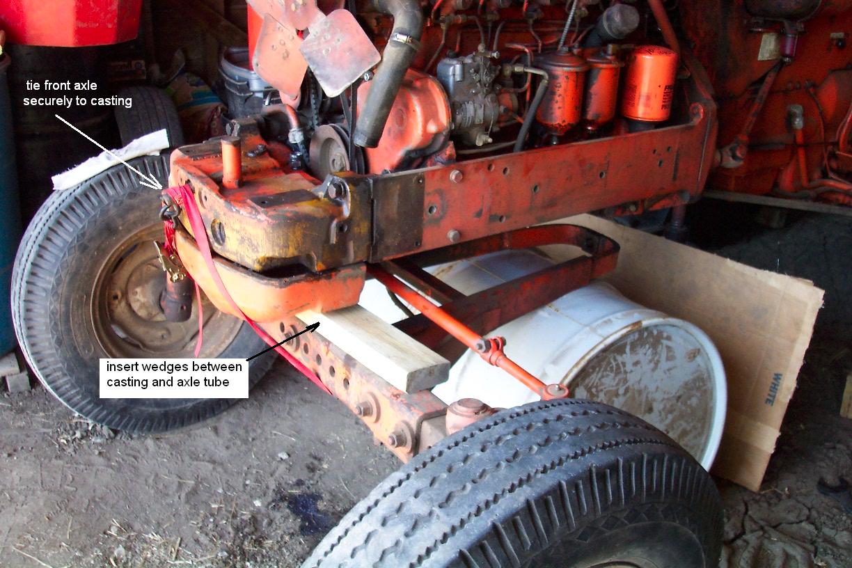

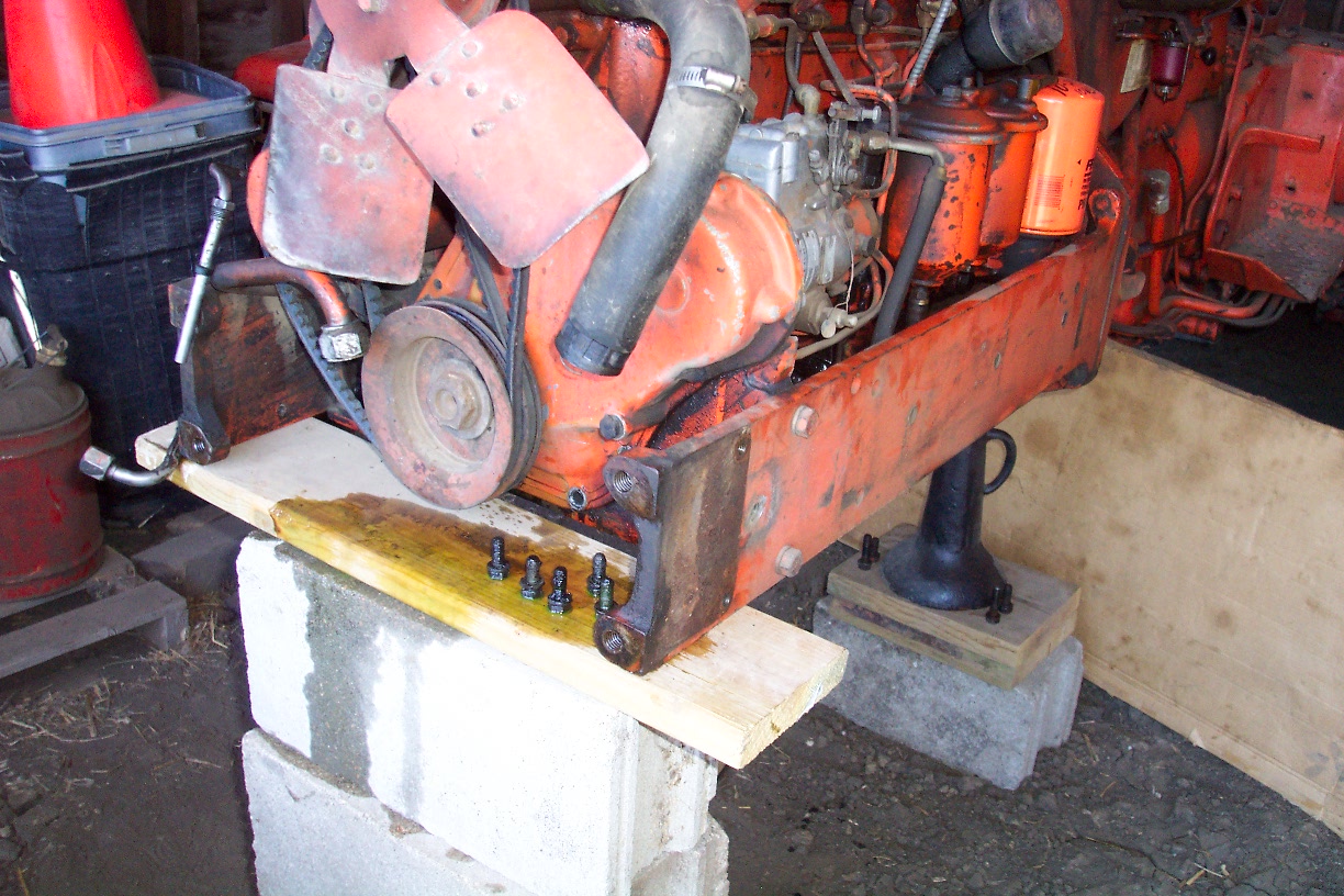

Here's the pix Dave was talking about.  This worked well.  But if yours is a narrow front, you'll have to come up with something else;  support is definitely req'd in either case.
1st pic shows the 55gal drum in position.  Not obvious here is the heavy-duty screwjack that was used to raise and support the tractor minus the front end.  It shows up better in the last pic
It takes a bit of finagling to get things to clear while it's being rolled out.

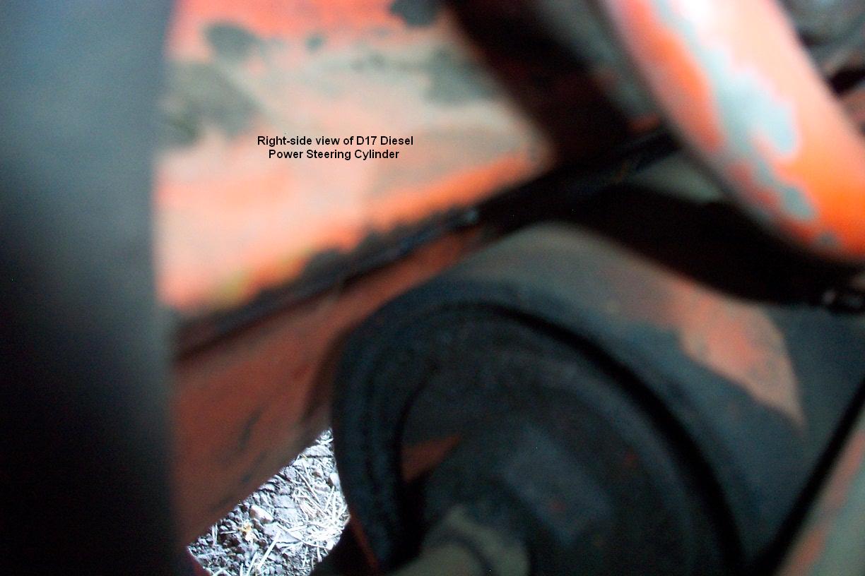

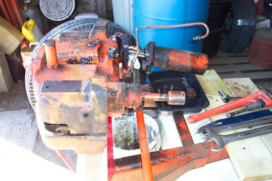

The P.S. cylinder flange-to-bolster casting developed a leak over the years, and this was the method used to get at it.  The rack was riveted to the rod-end of the cylinder and we attempted to get it separated, but it didn't cooperate.
Permatex #2 was the solution.  IIRC, Dave said it didn't leak after that.

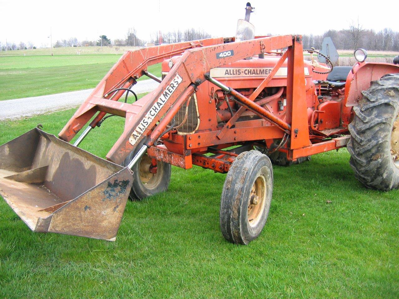

You might be able to leave the loader frame on, one less thing to put back.  My 400 loader is bolted to the frame, not the front casting.

You will want to take the lift arms, cylinders, and hoses off to give you room to work.
I left the frame that is bolted to the side channels  and rear axles on when I pulled mine.
I also just used a floor jack (not a barrel) to put under the frame and roll it out of the way.  You will need to strap the wheels to the frame as shown in the above photos to keep them from turning when you pull it forward.

Raise the loader clear up and safety block the cylinders so it can't fall on you. Loosen side frame bolts so you can spread the side frames a little bit when needed. Jack up under the bell housing and loader frame towers. let the fun begin. I'd never remove the loader.....just roll the front support and axle away.
