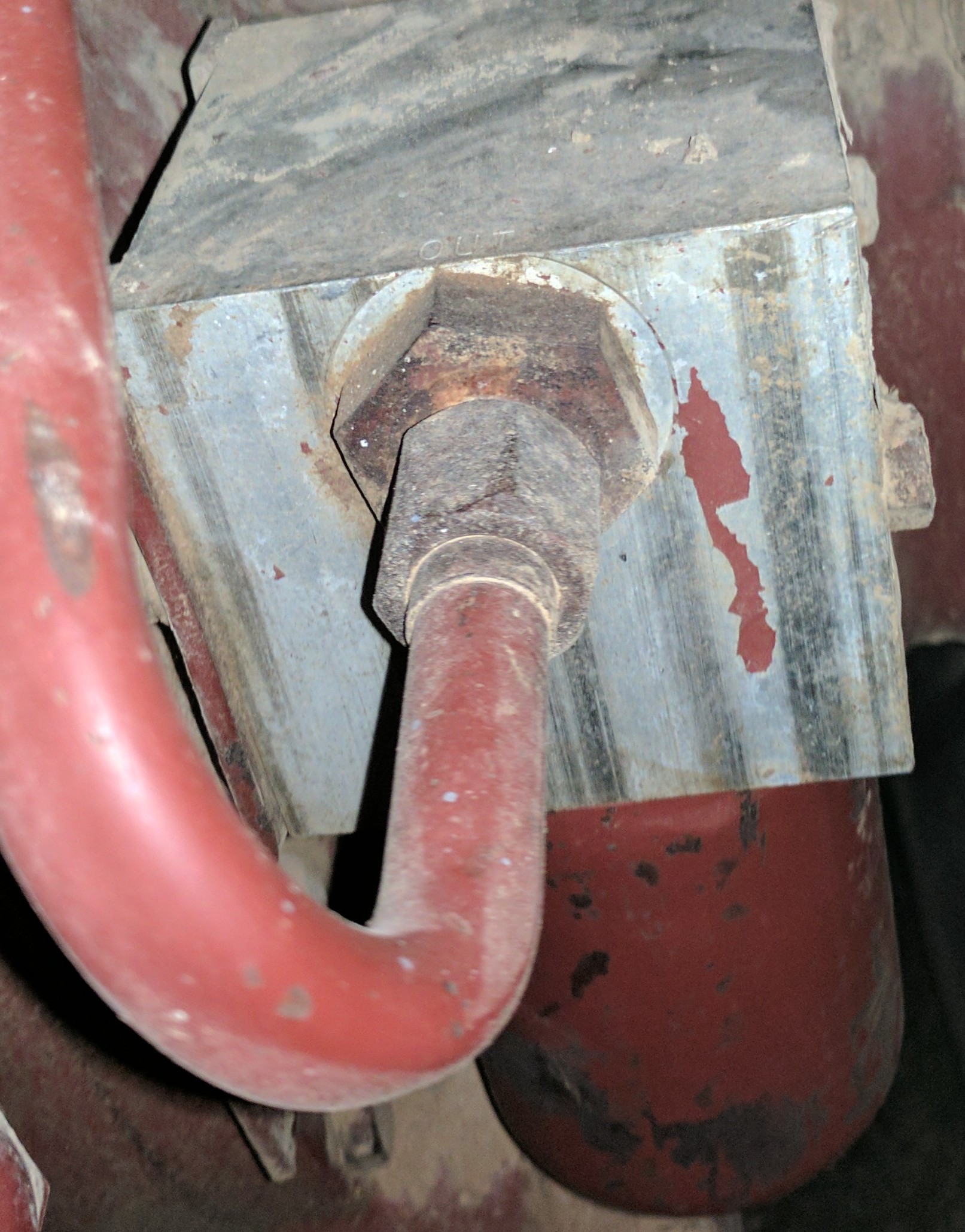

Post Options Post Options   Thanks (0) Thanks(0)   Quote 4267060 Quote  Post ReplyReply Direct Link To This Post Posted: 18 Apr 2017 at 9:35pm
This what I'm dealing with, not seeing a bolt running through it?

Post Options Post Options   Thanks (0) Thanks(0)   Quote 210Postin Quote  Post ReplyReply Direct Link To This Post Posted: 19 Apr 2017 at 5:01am
Yes that is what I thought you have, the bottom spins off  tell them you have an early tractor lot smaller filter than the later ones

IF you changed the 'belly' filters - LH and RH make sure you pulled the plugs out of the ends of the filters and put them in the new ones....  the...921 and ,,,922 elements.
Also look for the bypass filter element for the engine behind the engine - most remove it and plug the lines..change the oil every 100 hours then is the general recommendation. 70269842 is the pn for early sn ps tranny filters.
