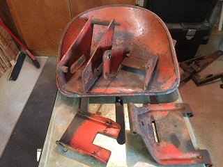

So I took the D14 seat apart last fall.  Finally got around  to cleaning it up a little today.  (Its only -4F out and we are now expecting a foot of snow).  I thought I took pictures of the seat before I tore it apart.  I either didn't take the pictures or I can't find them.
Does anyone have some pictures of the seat assembly?  Pictured below is what I currently have.  I will be sandblasting and painting before final assembly but I want to see if I can get it back together now.  Also need to find some 1/2" rods and bushings as I had to cut most of the old ones to get them apart.  Shock seems to be in good shape. Shock assembly (shock, spring, top and bottom cap) is not pictured because I have already cleaned them up, primed them and have them hanging in the warm shop.

Looks like you are missing the narrow part in the picture above.  I got all of the parts from DJS Tractor Parts.  He is listed in the parts section on this site.

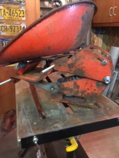

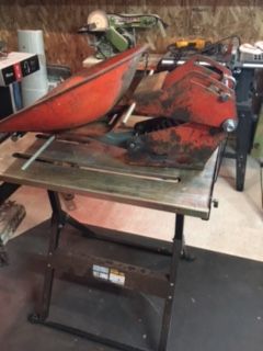

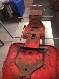

Thanks to the photos above, I was finally able to get my seat assembled.  What a pain in the ***.  Had to heat all areas to get the remains of the rods I cut to come out.  Now that I know how it goes back together, I can start restoring it.
Here are some photos for anyone else with the same problem
The seat pan has a crack.  I will try to weld or braze that later.  Had the day off today!  NO SCHOOL!  Winter storm hitting hard!
