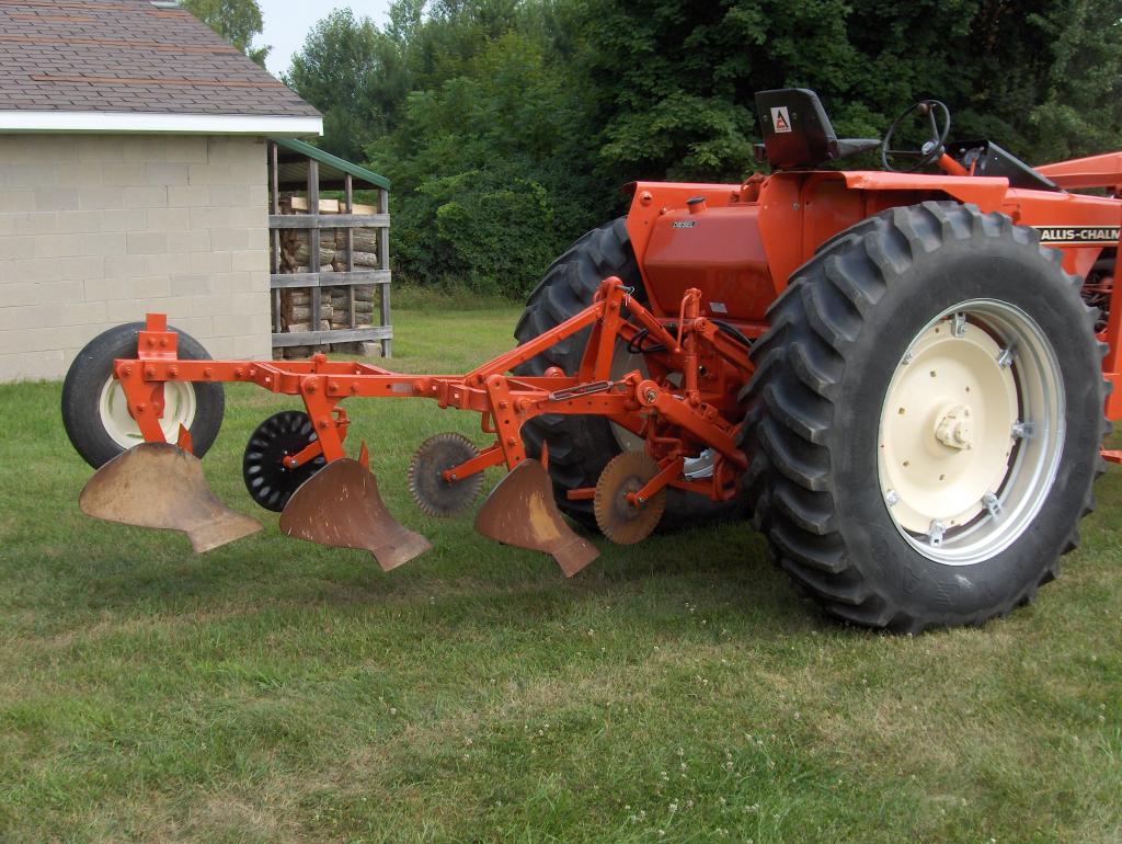

Here is a picture of our 200 with an AC 80 series??
3-18's plow. No fluid in tires and if I set it to low
it will stop the 200 in its tracks. I would not go any
larger that 4-18's in heavy soil. Our soil is a heavy
clay loam
Tractor305 View Drop Down
Joined: 30 Aug 2016
Location: 16157
Points: 8
Post Options Post Options   Thanks (0) Thanks(0)   Quote Tractor305 Quote  Post ReplyReply Direct Link To This Post Posted: 05 Mar 2017 at 5:54pm
Thanks for the pic 4x16 sounds good to me.
