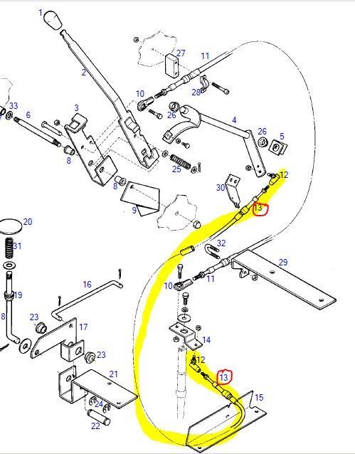

That did it!  By the small side cable, I assume that is the one on the bottom of the shifter?

agco partsbooks online, sign in as a guest, and see everything.

Post Options Post Options   Thanks (0) Thanks(0)   Quote DrAllis Quote  Post ReplyReply Direct Link To This Post Posted: 12 Dec 2016 at 12:06pm
Probably the small side-shift cable is stiff/sticking. Adjust all you want, but replace the cable first.

Post Options Post Options   Thanks (0) Thanks(0)   Quote Roscoe62 Quote  Post ReplyReply Direct Link To This Post Posted: 12 Dec 2016 at 11:59am
My 7010 PD won't go in to low range.  Just stays in neutral.  Sometimes by shifting a bunch between High and Low, it will finally catch.
Is this a cable problem, and is there an adjustment?
