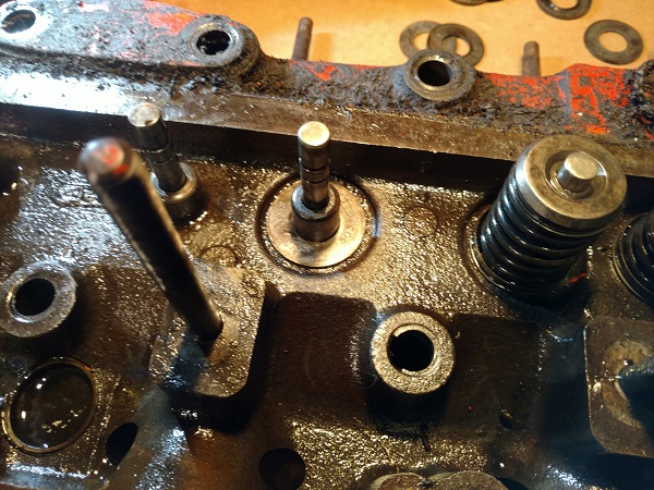

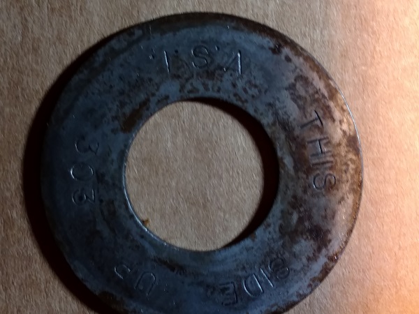

Was taking apart a WD45 head last night and saw something I hadn't seen before.  This head had been assembled with valve spring inserts under the spring seats.  i researched them on the web a bit, and it seems that they are primarily recommended for high rpm use, aluminum heads, and weak springs.  I'm re-doing the head and not putting them back,
but was wondering how often these were used in tractor rebuilds....seems to me that if the springs were weak, it wouldn't cost that much more to just use new springs....or were they thinking something else at the time......

When valve faces and seats are reconditioned, the compressed spring length/height increases. Those are to place the spring back into a proper height spec.

When u cut-resurface vales and seats valve goes in head ,shims make up spring compression. If installing new seats and valves u would most likely not need them .Shop done the head that understands how to do job correct. Not just grind everything and put back together

When I used to do a lot of cylinder head work, if the springs were just a tic under the seat poundage rate, a shim would bring the rate back into spec depending on the shim size. For just stock applications, it was faster to do that practice than to wait for new springs to come in which was more down time, and also more cost to the customer. On high performance applications, I would just go with a heavier/larger spring depending on the application. Most of the head work I did in my earlier years was Automotive. (Ford, Chev, Chrysler etc.)

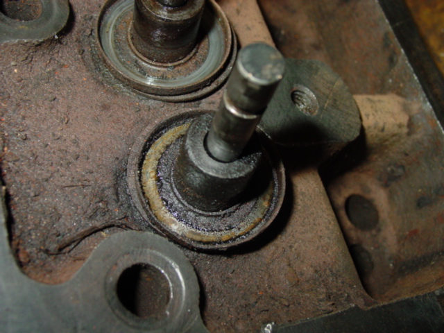

Oops. I had new valves seats put in my 45. Each of my valves had a little flat bottomed bowl (for lack of better term) with one of those shims in it. I just put it all back together how it was when I took it apart.

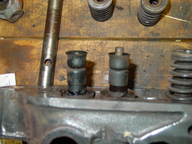

The only Allis B valve guides I have ever seen this sloppy had stem seals on them. I have no idea of the history of the engine but they had two seals on each valve stem. A head scratcher for sure.
