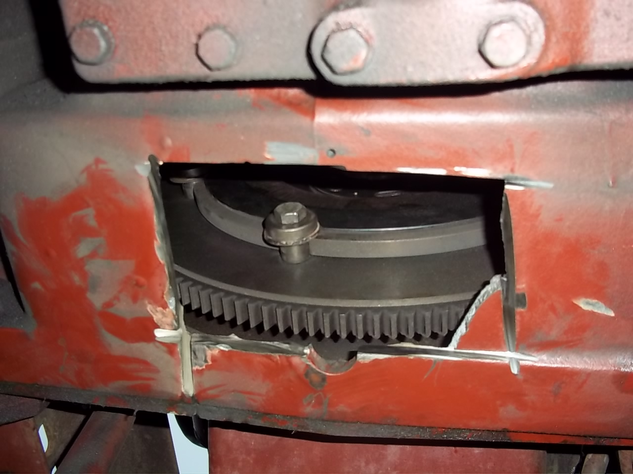

Okay I got around to doing the experiment and it worked so here it is,
how to adjust that POS torque limiter clutch while it's in the tractor. Tongue
Step one.   Cut a ~5" deep x 8" wide hole in the bottom of the transmission case right under the flywheel.
Step Two.  Take each 3/4" bolt and related top hat bushing off one by one and put a 1/16" - 3/32" flat washer under it between the top hat bushing rim and the clutch spring plate.
Step three.  Use it like normal tractor again.
Now the thing is our old AC 7050 had sat for some time before we got it and more than likely the rear seal on the engine dried out just enough to seep now.
Not much, maybe 1 - 2 tablespoons in a long day at best, but just enough to oil up that slip clutch and make it a real pain to use.
Now as for functionality it's just fine.   I put it in high 5th got it revved up and dumped the clutch and it slipped for aobut 2 -3 seconds before pulling the engine down to a stall.
When I got out there was just a whiff of oil smoke coming out the hole I cut so that says it clearly can still slip if needed.
Total fix time was less than 2 hours and all it needed was a 9" grinder, a 3/4" wrench, a large screwdriver and 6 fairly thin flat washers.    Wink
Beat splitting the tractor by a long shot! Clap

If they made the castings that brittle and light the tractor would have already broke in half years ago. Tongue
It's only ~1/4" thick and I probably could have punched a hole in it with sledge  hammer rather than bothered cutting it.    The plate under the PTO is thicker and higher strength steel than this stuff was. Ermm
Personally I think they could have easily put an inspection plate in there like other manufacturers tend to do for anything with a flywheel mounted clutch of any kind.
Maybe there is nothing to be adjusted in there but for piece of mind there can never be too many inspection plates on a tractor's driveline!  Wink
When I make a cover plate for it I may die grind it a bit.  It's pretty soft metal and will clean up rather fast and easy.

I recall you mentioning that in another thread awhile ago but I hate working on things in bad positions and in places I can drop stuff down into and not get to easily.
Also I had no idea how much actual adjusting range I had to play with either.   From the bottom getting a good straight on view so I could estimate the clearances between the spring plate and the backing plate seemed like a more practical method.   That and i couldn't drop important pieces in to some inaccessible place never be seen again either.
I thought about machining  them down instead of adding the washers but if I ever do have to split the tractor and put a new clutch in I didn't want them to be too short for later.

It was the most logical method and way I could come up with!
The primary load bearing areas of the casting seem to be pretty decent in thickness so I have every reason to feel this area is nothing more than filler.
To be honest I have busted out far more brittle iron than this from other brands of tractors and machinery.
Given the grinding spark characteristics and way it broke out  (semi malleable) I would put it as mid grade cast.  Not good cast steel but not JD's recycled soup cans and beach sand stuff from that era either!   Tongue

Originally posted by WD45Diesel57 WD45Diesel57 wrote:
Wow I would never cut structural parts of any tractor no matter how thin it is, take the time split the tractor as the dr said fix the leaky seal. Basically you put a band aid on a problem that is gonna get worse. When I did the torque limiter on my 7020 I had the motor out in less than three hours. Just my two cents !
Normally I would agree but everything I know about stress analysis and the appearance of the castings says that this is not a structural area by any bit imagination.  There is nothing of significance in any axis (front  to back or side to side) that it ties together that doesn't have a substantially greater structural casting bordering the whole area.
The side towards the engine terminates at the thick steel engine adapter plate and has no relevant structural significance to its function or stress loads and the majority of tensile the stresses in this area are on the two bottom most bolts that tie the transmission casting to the frame rails which is a 90 degree plane of stress to this bottom area.
I'm comfortable with it.  I've seen people blow far larger holes in machines that  went on to live to tell about it.  Wink

Given I had no easy way of  finding out how the castings were laid out inside the housing I had to do a bunch of exploratory 1/8" drill holes about  1/2 an inch apart to find the back edge of the thin bottom area I would be cutting out.   You can see one in the rear center area of the casting.
I went from the weep hole back then up the sides about 4 inches in each direction then ground things out right across the lines of holes.   I also had no idea how wide of hole I would need to make so that's why no large diameter corner holes were drilled.
This was all poke and go exploratory cutting work.   Wink
Now that I know the basic dimensions and metal thicknesses of the area that can be cut out if I had to do it again I would either use a 1" bi metal hole saw bit and put the four corners in then cut between them and given as thin as everything turned out to be I would do the cuts with a small angle grinder and cut off wheel.
Either that or use a 3" - 4" bimetal hole saw and cut a pair of holes side by side, and go in that  way.
I know it wasn't a perfect let alone ideally done cut job. It was never intended to be but some post clean up with some more detail grinding and die grinder work won't take long to fix it.
Mostly the only reason I posted this fix is to show that if a person chooses to they can get into the torque limiter assy and tighten the thing up in less than 2 hours work with basic tools if they need to get a tractor going again opposed to sending it to a shop and waiting a week or more plus spending a few thousand having it done.   Wink
When it's Saturday evening and your tractor stops moving and you don't have the resources to easily split it yourself plus your nearest shop that can do it is either a very long tow (or implement truck hire and haul plus a week or two wait start to finish) away and you really don't have a few thousand dollars to throw at fixing an old tractor and you see that someone online shows it can be accessed and bolted tight in a hour or two's work with minimal tools which are you going to take to keep it running?    Ermm
For me cut the damn belly open, stick 6 washers in it and be back in the field in less than 2 hours would be it! It's that or abandon the tractor/scrap it if I don't have the time and money to toss at fixing it. Wink

Interesting being the main reason I keep hearing about why AC aren't worth crap is because they are poorly supported by their own parent company and expensive to operate and fix.
 So, yea, exactly as you said, guys have to chop them full of holes and cobble them together as best as they can to keep them running which leads to them not being worth much more thah scrap prices to the next guy.
That's why I did what I had to do to keep ours working.  Dealer support is (has been for a few decades now) and everyone who has to get anything done these days don't by AC machinery because of it.  No dealer support.
So yea if my cutting an access hole in a single  AC 7050 brought down a company that been floundering and failing for the last 30+years (because every other AC equipment owner has to resort to similar fixes to keep their machines working too)  I rather suspect that it wasn't a company that was worth crap that made or supported anything better than crap and a half to begin with.   Tongue
Edited by Tcmtech - 31 Oct 2016 at 11:22am

Put the piece back in, weld it, problem solved, jmho, Trev.

Welcome to the internet, where you can post what you did with pictures and everyone will chime in to tell you how you did it wrong/bad. If someone asks for help, I don't mind giving it. If someone posts how they did something and it doesn't agree with what I would have done, I don't say anything unless there is an imminent danger. Obviously what's done, is done, so really beyond recommendations to clean up/strengthen the spot, these comments are just unconstructive banter.
