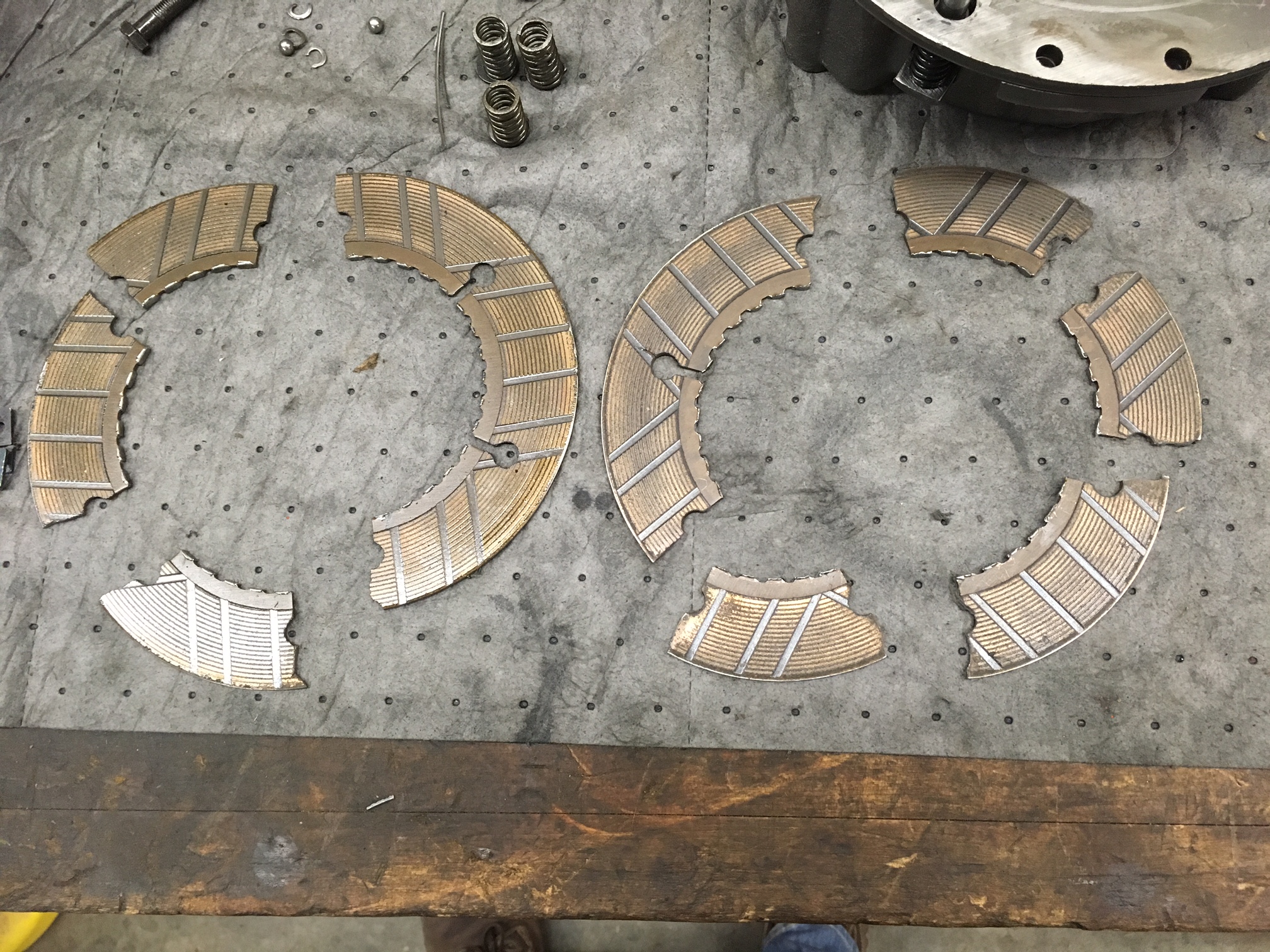

Well, I managed to get er tore apart, and discovered the problem as soon as i split the torque tube from the tranny and saw burnt clutch material splattered all around the inside of the housing. Needless to say I pulled the clutch assembly apart and found two broken discs, as well as a couple burnt separators. When is comes to replacing the discs, keeping cost in mind, is it recommended to replace all of the discs and separators or can I just replace the discs and plates on the high side?

Post Options Post Options   Thanks (0) Thanks(0)   Quote DrAllis Quote  Post ReplyReply Direct Link To This Post Posted: 15 Nov 2016 at 10:55am
If you never want to work on it again, replace ALL discs with new 70261212 discs from a model 7000 tractor. You'll see the difference in the design change, so they'll never break like the old ones did.
