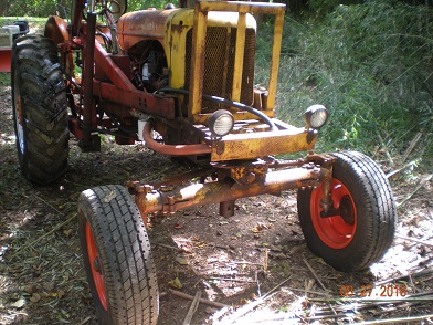

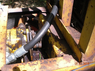

   My pump on my WD is driven from the pulley on the front end of the crank mine also has power steering so pulley has two belts and the ID of pulley is splined for a short shaft that goes out the front to a coupler that drives the HYD pump for a loader.
My pump is a Vickers #V2 1S13R15A 20L
The seals are bad and the coupling is beat I would like to replace them both I figure I'm looking at $500.00 would like to get this done cheaper if I can.
They aren't so great but here are a few pic's of mine.

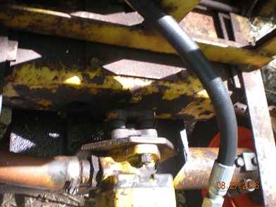

Here's is my front pulley ,has a splined insert in center with rubber bushings around each bolt.
Hard to see in the pic but there are splines on the end of the shaft.
    Probably need to align in the same manner Dr Allis described and looks like this one is drilled and tapped for the 4 bolts.
Don't have any idea on part #'s probably any place that makes hydraulic hoses might have or know where to find this type or similar couplings.
