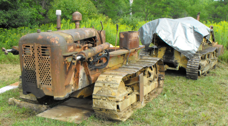

I just acquired an HD5B with Garwood angle dozer that had been in the woods uncovered for many years. We dragged it out with the steering clutch levers tied back. The left track was not moving. When we got it to a place where we could work on it, we spent 7 hours trying to get it free. I removed the fuel tank and disconnected the brake band. With the master clutch disengaged and the transmission in gear we attempted to rotate the driveshaft. We pushed and pulled it with another dozer. We even lifted most of the machine by a grouser below center of the sprocket. After we removed the blade and sprocket guard I learned that I could generate as much movement as with any of the previous methods by prying on a sprocket spoke.
It was getting dark and we were being pressed to move it. We lifted it by the track with a loader on each side and backed the trailer underneath. We put boards underneath the dead track so we didn't damage the trailer.
Now it is really dark and we are all really tired. We knew it wasn't going to come down the trailer ramps because the slightest pull from any direction caused the HD5 to rotate on the trailer. Remove the ramps and pull it quickly. It was a small drop from the beaver tail trailer but the HD5 almost rolled over. When I pulled it with my HD6 the dead track moved correctly.
Now the reason for this long story is Next time you have a dead track drop the machine off a trailer. That will fix it.
I have had a couple days to work on it and aside from the rust it is in good shape. If anyone has the floor panel with shift lever gate, I need one. The ring and pinion chamber and the transmission didn't have any oil. The motor oil was at the proper level. The exhaust pipe was not covered so I will pull the cylinder head and hope for the best. Today I raised the left track so I can work on the steering clutch. I stopped because now it is raining.

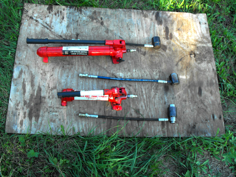

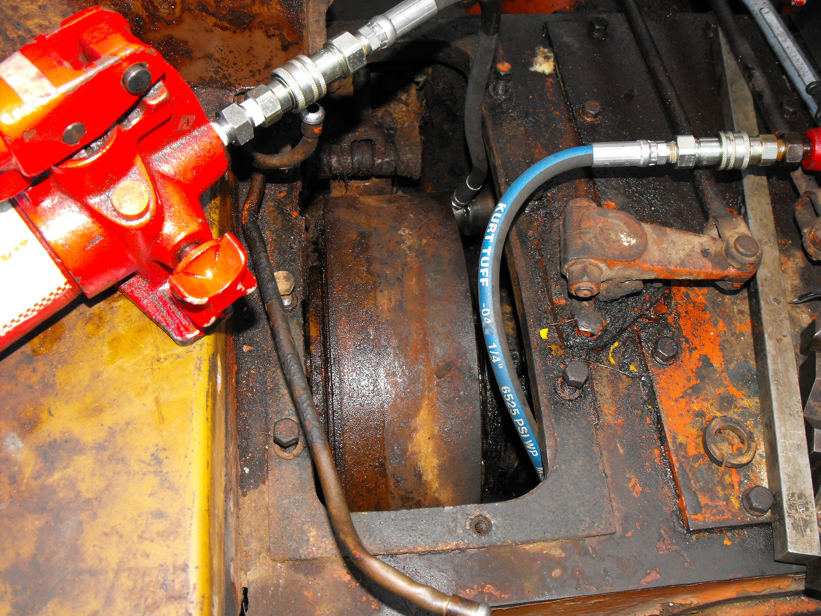

I have the bad steering clutch side off the ground. The other steering clutch disengaged. I have removed the bolts on the inboard side of the steering clutch. I have (2) portapower cylinders trying to push the clutch pack into the drum.
I can easily generate 3000psi with my portapower pumps. At 3000psi each cylinder generates 3680# force. I'm using a pipe extension on the portapower so I'm generating a lot more force. Look at where it says 1/4" on the hose. I do not have the 1/4" required to remove the assembly. Does anyone have any suggestions??? I hate to cut the drum.
I learned that the 4 ton and the 10 ton portapower pumps generate the same pressure because they have the same diameter pistons.

I am still trying to push the steering clutch pack into the drum. I can not get the assembly free from the inner and outer flange at the same time. I did manage to get the cylinder head off

I made several small hydraulic cylinders I use when I work on steering clutches. The 6 ton and 10 ton pumps produce the same pressure. It is easier with the longer handle on the 10 ton pump. I use a pipe extension until I hear the bypass hiss. I'm still hope I can get the clutch pack to move.

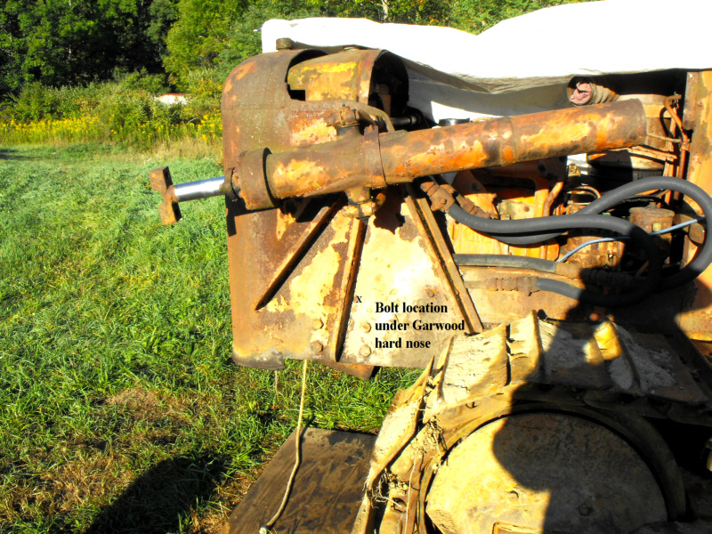

I have removed the front floor plate so that I can get to the nut holding the fender at the rear. At the front of the fender is one of the two original bolts. X marks the location on the picture.
I can get to the nut but the bolt is under the Garwood hard nose. I understand why mechanics do not put the fender back once removed

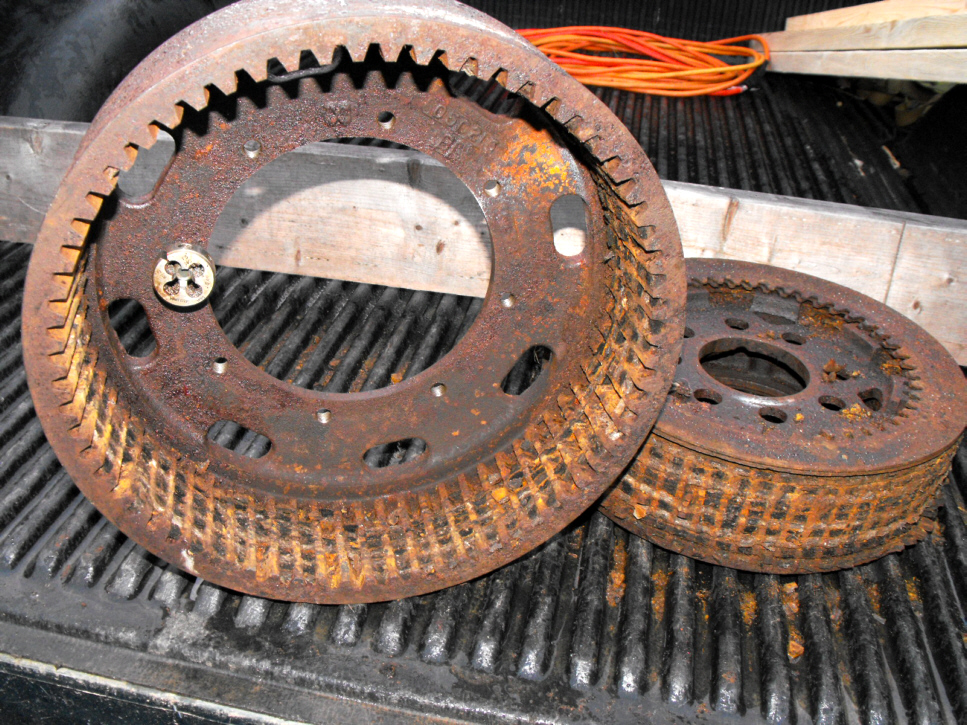

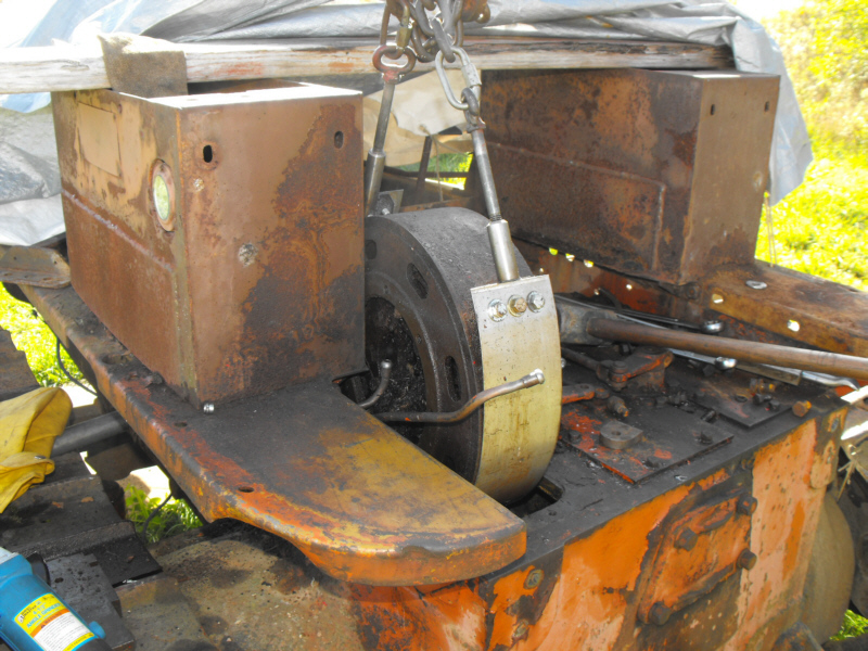

I have been working on removing the steering clutch trying to push the clutch pack into the drum using (3) hydraulic cylinders. I used about 1/2 gallon of "KROIL" and moved the hydraulic cylinders to a new position every few days. I bought another pressure gage and measured the pressure from my porta power while using a pipe extension on the handle. 8,000 psi translates to 14,000# at the hydraulic cylinders. This exceeded the working pressure of the quick disconnects I was using. I broke 2 of them. Today the steering clutch came out.
I had to grind off part of the fender near the battery box to get it out. When it was out I was able to see why it was so difficult and took so long. The trunnion pins on the yoke came out so the fingers on the throughout bearing were not retracting. I was unable to see this while the steering clutch was in place.

Dozer - Excellent progress on the steering clutch.  That's a nice carrier you made to pull the clutch  - what components comprise the carrier?

I have always used the brake band when working on Caterpillar stuff. As that is Cats recommendation in there book.

I have been trying to get the steering clutch for almost a month. I tried hitting it with my 8 pound hammer but it wasn't moving. I put it in my arbor press and every few days I would reposition it and push some more. Today the hub and clutch stack came loose from the drum.
Note the spline part of the frictions are in the drum spline. I was pushing on the pressure plate. what was a flat pressure plate is now bent conical. If anyone has a pressure plate p/n 050218 send me a pm

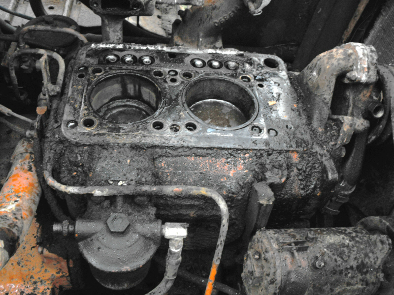

The motor stopped with both pistons mid stroke. I put Kroil in the cylinders over the winter. I have been trying to adjust the piston position in the bores using a piece of oak turned to piston diameter and my 8 pound hammer. broke the oak, pistons still at mid stroke. Took both rod caps off, good oil, bearings look very good. Advise please. Should I open the air box and remove the blower to lubricate the pistons thru the air holes?
It took me over an hour to remove the con rod cotter pins because the crank was in a bad position. I don't like cotter pins.

I would just pull pistons and liners out together, you're going to have to buy new ones to put in anyway. To make it easier just weld an eyelet or whatever inside the liner to  be able to pull them up. Those liners can be in there really hard before they budge. On an old engine like that it can take an enormous amount of force to make them let go. Being that you are a smart machinist you can make a puller to lift them out.

We used a spring loaded handle to lock into the air intake ports to use the pistons to drive the sleeves out. With rods unbolted should be easy enough to jack them out as are dry sleeves. When you replace them there are different sizes, the sleeves will need to be hone fitted to the block for a snug slip fit. Too tight will seize, too loose will rip them apart at the intake ports. Used to be able to get Std., .001, .005 and .010 oversize sleeves, then there was a secondary sizing of light or heavy as to any of these where each had a Detroit sizing stamp placed high or low or mid-position on the sleeve. Had to use a Sunnen style hone for accuracy, a deglazing hone will not cut square top to bottom.

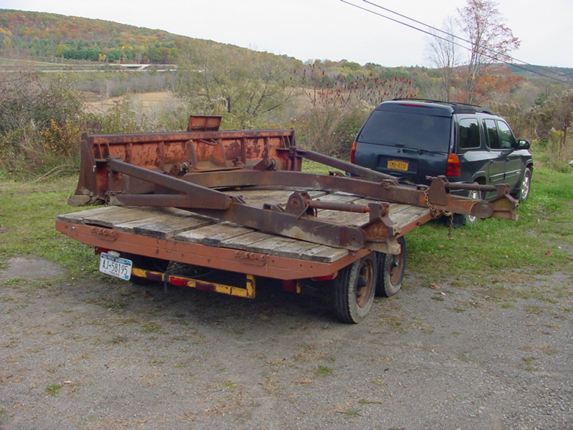

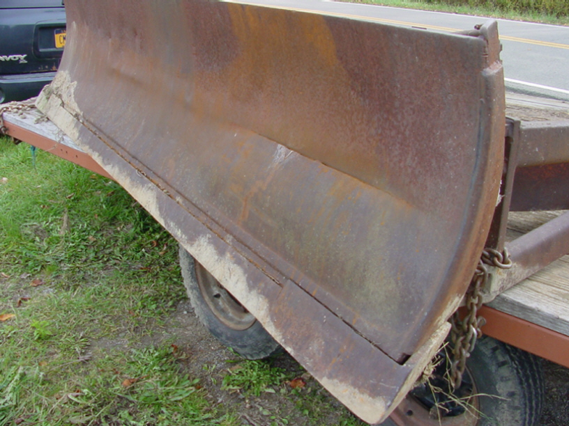

I brought the Garwood angle blade home today
This blade is going to need a lot of work. There is a crack in the blade that allowed water to get trapped between 2 layers of the structure. Notice the bulge in the next picture. Any suggestions as to how to bend it back? I do not think my largest hammer is going to do it.
