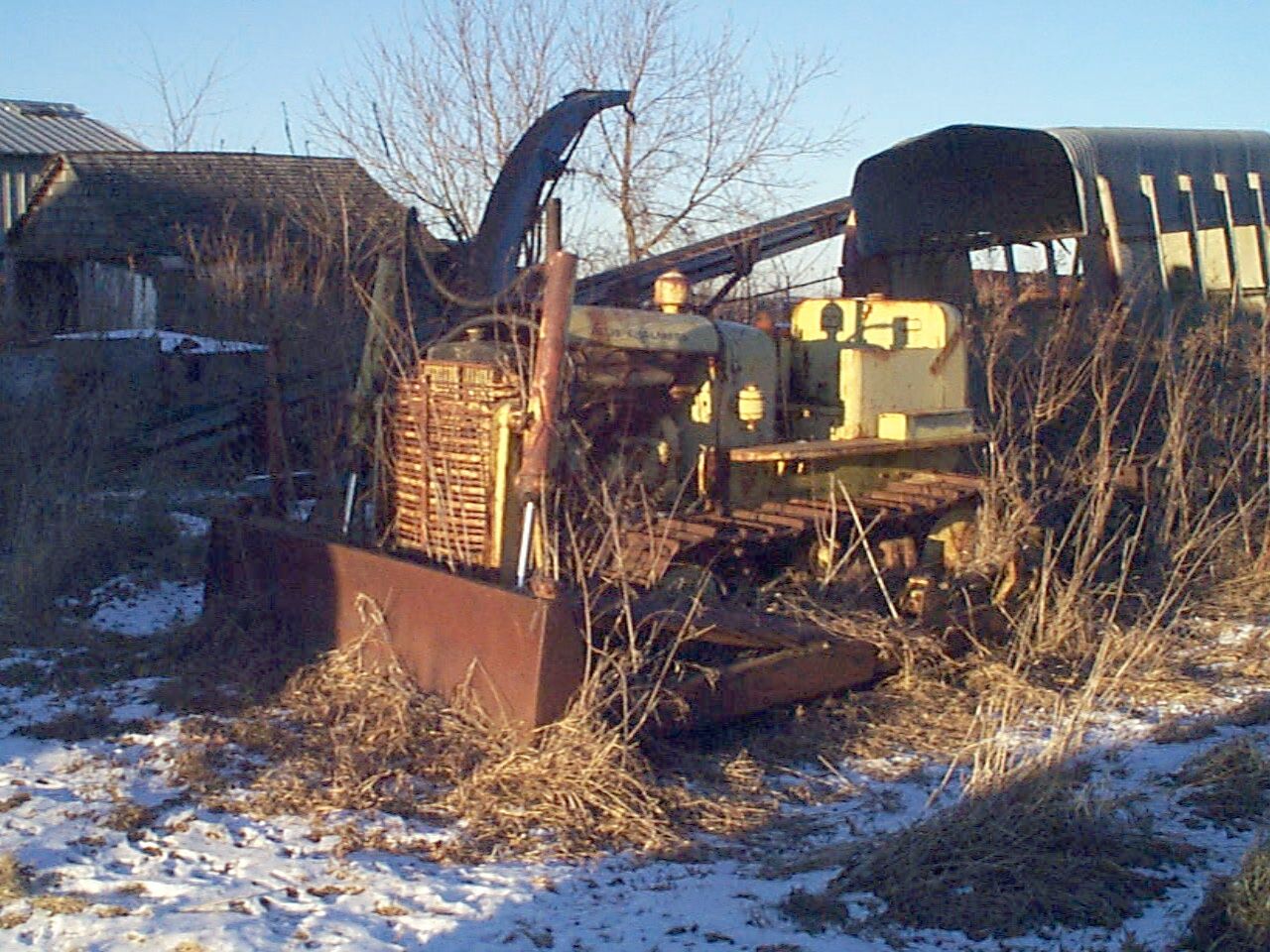

I just acquired an HD5B with Garwood angle dozer that had been in the woods uncovered for many years. We dragged it out with the steering clutch levers tied back. The left track was not moving. When we got it to a place where we could work on it, we spent 7 hours trying to get it free. I removed the fuel tank and disconnected the brake band. With the master clutch disengaged and the transmission in gear we attempted to rotate the driveshaft. We pushed and pulled it with another dozer. We even lifted most of the machine by a grouser below center of the sprocket. After we removed the blade and sprocket guard I learned that I could generate as much movement as with any of the previous methods by prying on a sprocket spoke.
It was getting dark and we were being pressed to move it. We lifted it by the track with a loader on each side and backed the trailer underneath. We put boards underneath the dead track so we didn't damage the trailer.
Now it is really dark and we are all really tired. We knew it wasn't going to come down the trailer ramps because the slightest pull from any direction caused the HD5 to rotate on the trailer. Remove the ramps and pull it quickly. It was a small drop from the beaver tail trailer but the HD5 almost rolled over. When I pulled it with my HD6 the dead track moved correctly.
Now the reason for this long story is Next time you have a dead track drop the machine off a trailer. That will fix it.
I have had a couple days to work on it and aside from the rust it is in good shape. If anyone has the floor panel with shift lever gate, I need one. The ring and pinion chamber and the transmission didn't have any oil. The motor oil was at the proper level. The exhaust pipe was not covered so I will pull the cylinder head and hope for the best. Today I raised the left track so I can work on the steering clutch. I stopped because now it is raining.

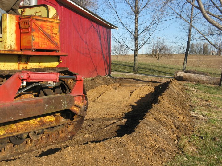

I have a similar blade that doesn't angle on my 7.  Sorry the first picture is so large.  It was taken quite a few years ago when I found it on a prehistoric digital camera.  I thought you might like to see how I reworked it for power tilt.  The lines are crisscrossed between rear cylinders and the valves.  It works great.
Posted By: jebbesen
Date Posted: 12 Mar 2019 at 2:33pm

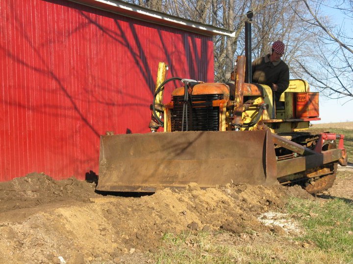

I thought I had a better picture of the rear cylinder mounts.  Here's the best I can find right now.  I made them out of 1" plate and burned them on in place of the turnbuckle mounts.
Posted By: JohnCO
Date Posted: 12 Mar 2019 at 10:38pm
Once the machine is running and the blade back on, why not just push it into a pile of dirt and see what happens?
