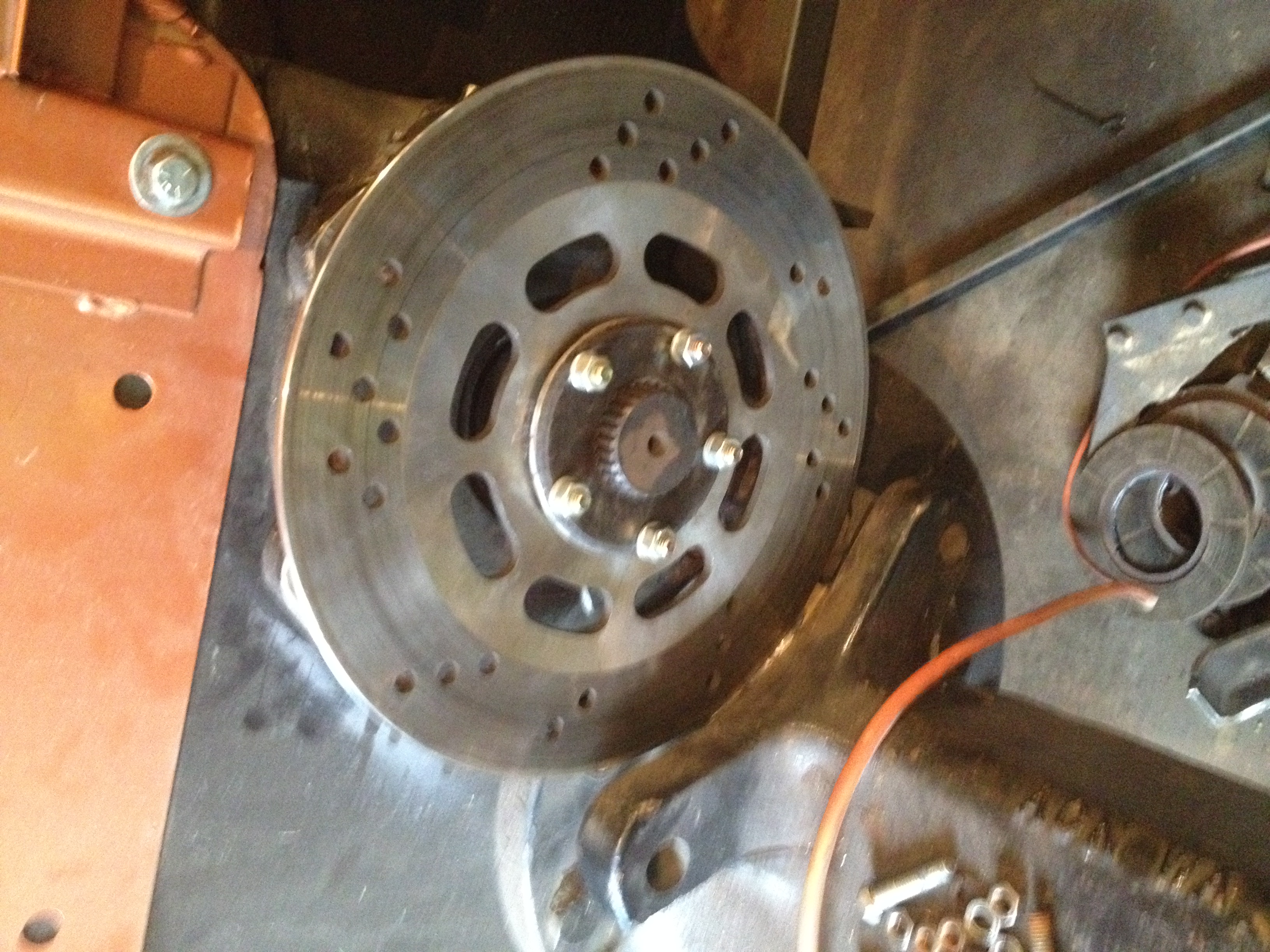

if I could get pics to send off phone I'd send my homemade setup and works great!!

I could text or email if someone wants to post em

It let me do one pic only but it's Harley rotor and 4 piston caliper from a road glide and master cylinders from jegs
