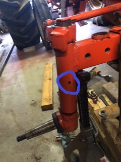

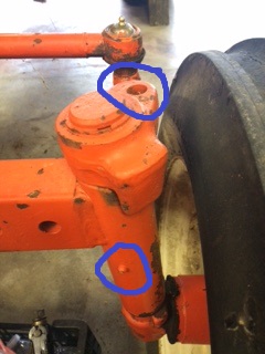

Hi guys, just bought my first tractor, an AC D17 series 1 and wanting to do some general maintenance to it.. so you will see a lot of posts of simple questions...
First off: I am repacking the front wheel bearings and wanted to get a new felt washer or if it is really needed. I also thought I would repack the spindles but don't know how to get past woodruff key I think it is called below?
Also, on the 2 pictures below, there is a hole on the front of both left and right spindles but I don't know if that was to lube the spindles as one side has just a hole and the other just has some type of metal plug in it.
Also, on the left spindle arm there is a large diameter hole that I was just curious on why it was on that arm and not the right one.

On the second picture, install a new grease zerk on each spindle knee and grease...that's how you grease the spindles. Rick

The large hole is for power adjusting the front wheels, if other one doesn't have the hole it was changd at one time or broke, sound like you need an owners manual. I think they called the front adjustment "roll shift front end".

Also if both zerk holes are in the front one has been changed, there was no left or right to them I tink so one zerk would be in front and other in the back from the factory so mt guess is the one without the big hole in top has been replaced.

Ok that makes sense. I guess those zerk fitting are threaded I will attempt to take the old broken one out to see what size I need to buy. Where would I find the felt washers to put on the back side of the wheel bearings?

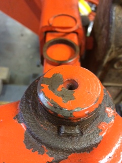

There is no splined shaft. All that holds the spindle is the keyway and the steering arm and that can be a bear to take off the top of the spindle without heat.   Rick

They come apart fine. Just need a rose bud torch. I've been over this many times before but here goes again. Heat the arm around the spindle shaft red hot. Good and red. The shaft is separate enough that it won't get as hot as the arm if you just direct the heat onto the arm. Don't heat the shaft red hot. Douse with cold water when red hot. Tap off arm or use a puller if need be. If will come off easily. When you put it back on just heat the arm again red hot. Be sure the key is in place in the shaft. With a pliers set the red hot arm back onto the shaft and lightly tap into place before it gets too cool. Let it cool on it's own and it will shrink tight onto the shaft. If you do it another way you may end up with a loose fit over time. My way works and works every time. Actually it's not my way. It's the way I learned it working at an Allis dealer 20 plus years ago.
The cold water freezes the arm in its expanded state and makes removal easy. Works on 7000, 8000, and Hundred series just the same.

I don't even own a torch, but I use a large heavy piece of brass rod and an 8 lb. sledge and they come apart just fine for me. I've never heated them. I figured a guy might understand how hard they CAN be to get off, if they didn't use a torch or something to heat them with first. So everyone has their own way of doing things, I guess. Rick

The hole in the front of my spindles seem to be 5/16 and don't seem to have threads, does this seem correct? Does anyone know what type of fittings I should purchase?

Yep they are actually the non-threaded pound in style, any local dealer should have them or your local farm store, just put new ones in mine and they were only .52 a piece

I believe that they are 1/8 inch pipe thread. A very common grease zerk thread size.

Pull the outer axle assembly out, turn up side down and slide back in then drive the arm off. Much easier to swing a sledge hammer down than up.
Service manual says to cur arm off and install a new one. (price one first)  MACK
