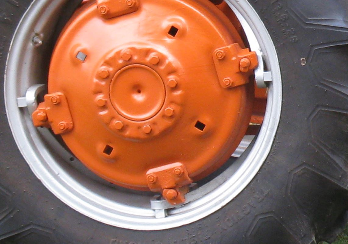

I dont think 26 inch rims came on a WD45 either........ but here is a picture of the bolt pattern.. I can not say for sure, but sure LOOKS the same as the 180.

You'd have to get the tire, rim and center complete to switch, like what is in picture. It will be a lot smaller/shorter/narrower than the 18.4x28 tire. May drive funny. Could be used while getting your rim repaired.
 IF it was me, I'd want the other tire back on the tractor ASAP.

I think what he is looking at is 26 inch combine rims/ tires that are on a WD45.... What he wants to know is if the bolt patter is the same.. He will remove the tire / rim / hub off the 180 and install the combine rims straight to the axle..
I "think" the WD45 bolt pattern is 8 bolts on an 8 inch circle, with a 6 inch pilot hole ?    I believe that is what the Combines used.......Darrell... you might be able to check the bolt pattern on the 180 and see if it is 8 inch circle..

Am certain the 8 bolt pattern is the same on WD's, D14-D17, 170-180's. Need to consider if the inner wheel will clear where the drop axle mounts on

The 180 has a standard 8 bolt AG pattern. Many Ford, Massey Ferguson, International, Case and basically any color farm or industrial tractor will have wheels that will interchange. Sometimes the dish/offset will not clear the final drives though.
