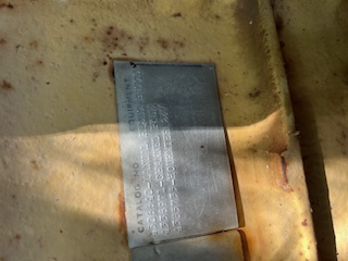

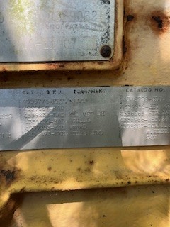

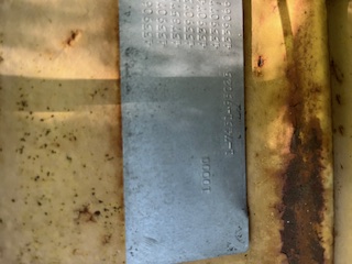

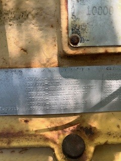

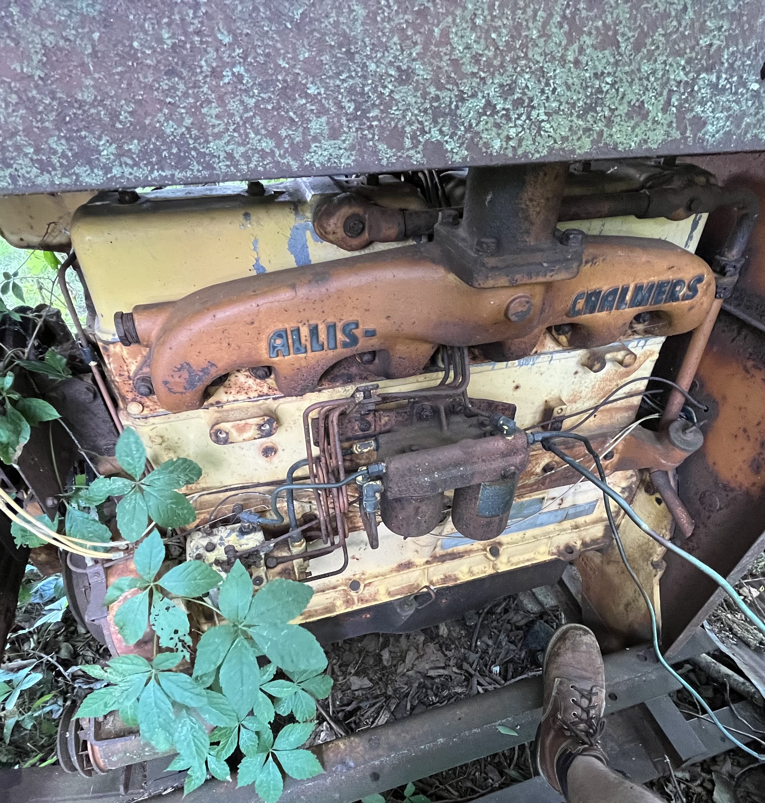

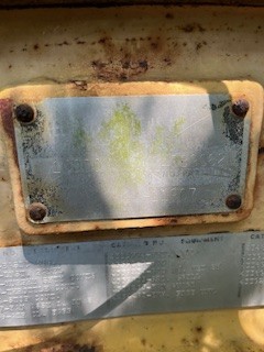

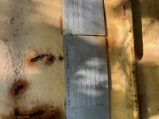

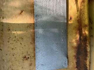

Please shed some light on this engine.

From what little I can see, I'd guess a 844, from the split valve cover and the writing style on the manifold...

Model 10000 engine..... 516 cubes....6 cylinder......no turbo?......probably rated at 100-120 HP.

10000 series engine like the Dr said. The 10000 series engine didn’t have a turbo; the 11000 series engine had a turbo and that was the major difference between the two.
They both have 2 cast aluminum valve covers. The smaller ID name plate is in pretty bad shape but you can read the series number on it (10000 ). On the longer name plate list all of the options that were on it when it left the Harvey engine plant. The group number would list every item that was required for its makeup and installation. An example would be the Fan Group. Looking up the group number in the master materials book you would fine a detailed list of every item by part number and quantity of the parts needed. An example would be the fan blade, such as it could be a sucker or a blower.

Out of interest - what is the injection pump on it?

By appearance Stanadyne

Id have to get more pictures and let you know for sure about the pump. But engine was used to run a small saw mill.
