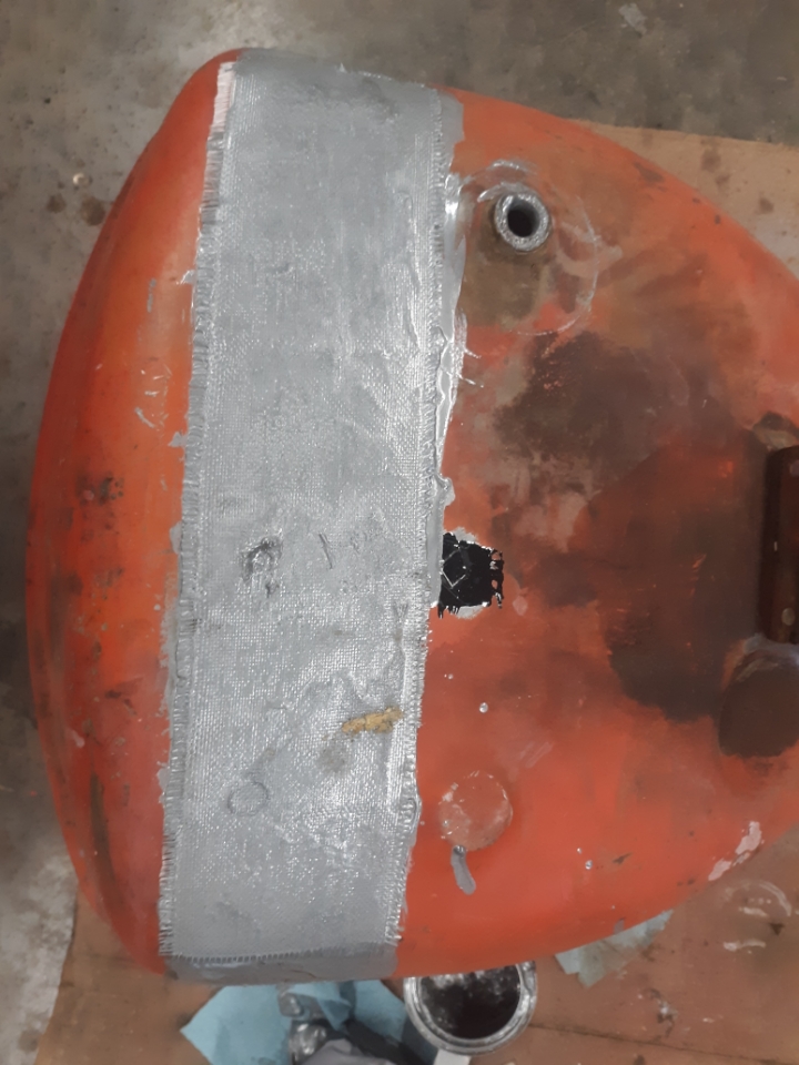

I showed where the fuel tank had been removed, cleaned,flushed, then sealed. I also laid some fiberglass mesh on the bottom side where I opened up some pinholes after the cleaning, coating the mesh with sealer.

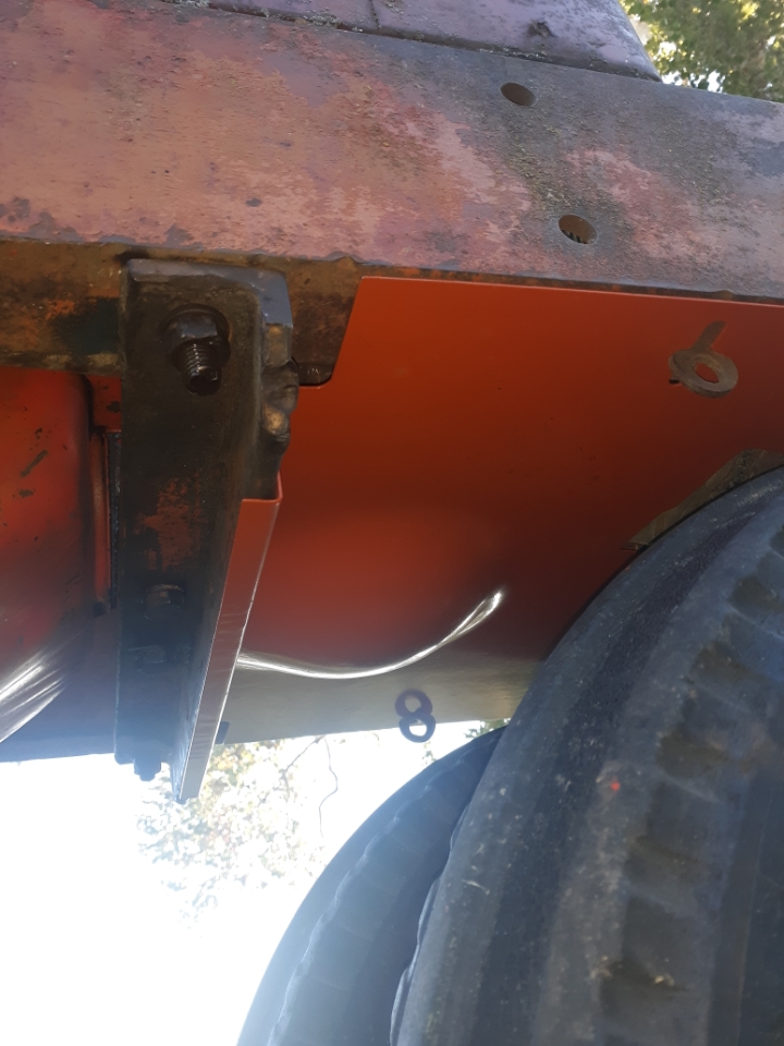

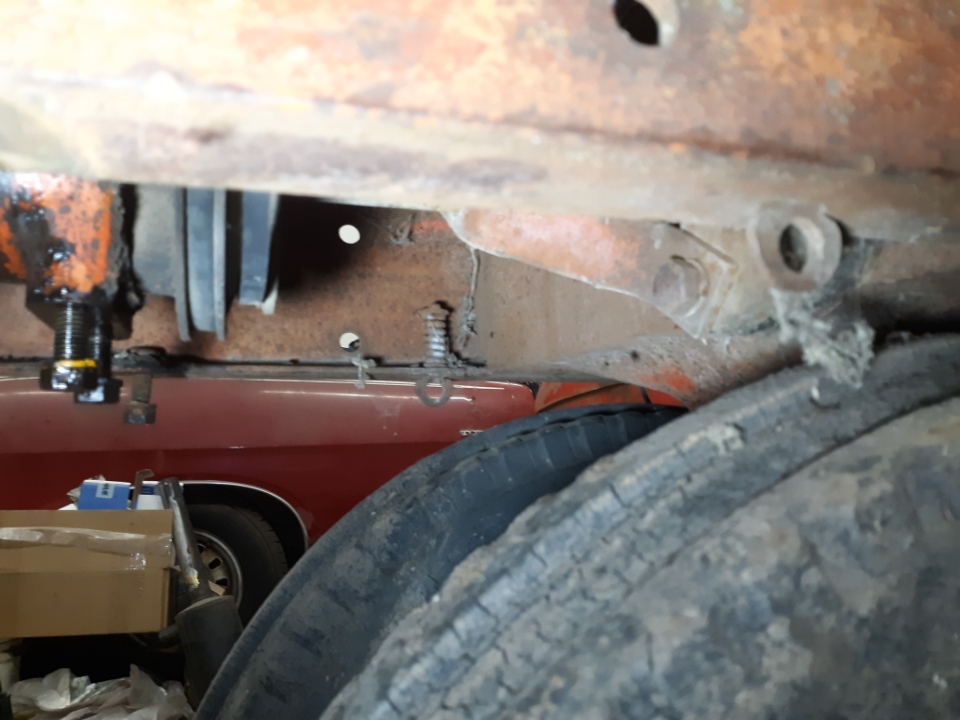

The pan gasket set arrived today and the end gaskets are currently taking its new shape in a nut container. I had enough Plastigage to check clearance on two rod bearings. Measures out to .0015"-.002". Pushed the "dent" in the oil pan back out so will drain completely next time. Found these spring loaded loops hanging under the frame rails.
Any idea what these are for?

There is a guard that is used on tractors with factory power steering narrow front ends. I have that part for sale if you are interested.

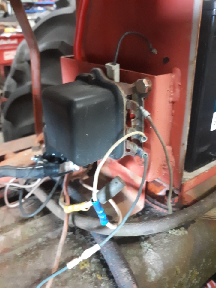

12v negative ground system. Delco 10DN alternator. Appears to have been wired similar to the wiring on the 170
Couple broken wires. Assuming the top one goes to ground but don't see a terminal it could have been attached to. No ground wire found on the alternator ground lug.

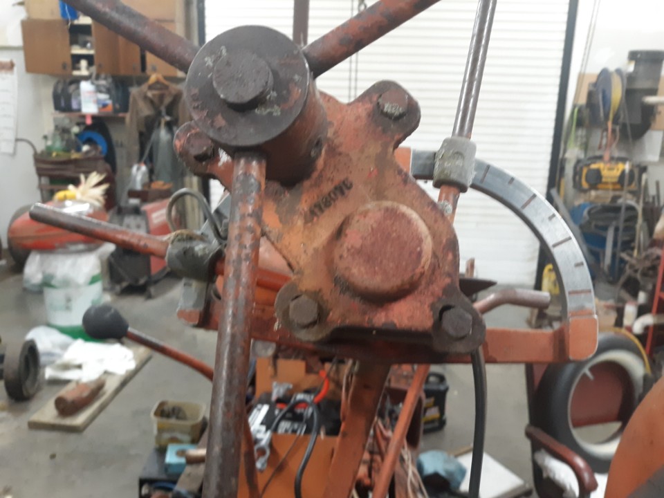

Steering relocate kit. Found an old thread on that. There's a chain inside all rusted up. Soaking in chain lube now

I would dump that voltage regulator and the OLD style alternator and get a NEWER 10 SI or CS 130 Delco and install it... They have an INTERNAL regulator and much more reliable.

So this showed up on my doorstep today.
Had asked earlier what the spring loaded rings were for. Panel covers the belt area keeping out dirt and such from the NF tires Lon provided this for the project. Thanks much.
Points: 9005
Post Options Post Options   Thanks (0) Thanks(0)   Quote SteveM C/IL Quote  Post ReplyReply Direct Link To This Post Posted: 21 Oct 2023 at 12:00am
It's to keep MUD out of the belt and pulley. Dirt is not an issue.

What's the purpose of the relocate kit? I don't see any gear reduction. For tall farmers???
Points: 9005
Post Options Post Options   Thanks (0) Thanks(0)   Quote SteveM C/IL Quote  Post ReplyReply Direct Link To This Post Posted: 21 Oct 2023 at 9:47am
Hard to to count but i'm sure the driver has one less tooth....gear reduction
I came across an old thread on here. Supposedly to relocate for certain mounted picker. The seat would be located on the picker. My uncle however is quite tall and am sure it was much better to drive for him.

Tooth count is the same for both so no gear reduction. Just a method to raise and center the wheel over the platform. Seat is also moved to center and a padded seat added. I'll add a picture soon showing the offset.

    In 1958 we put a Ford 2 row mounted corn picker on the WD . That was used to raise and center steering wheel.
