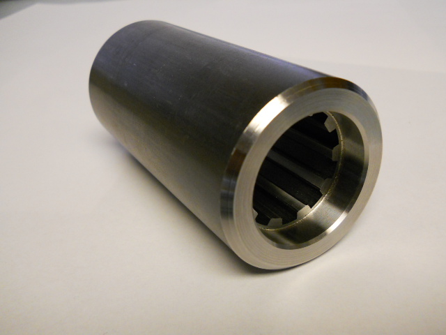

are you talking about just removing the hand clutch to prevent slippage?
you can bolt the clutch together by using 2 of the pto drive gears, or you can use a splined coupler from a wc trans to pinion shaft. several different ways to accomplish this. think you could probably bolt the clutch together if you weren't wanting to also lose weight
