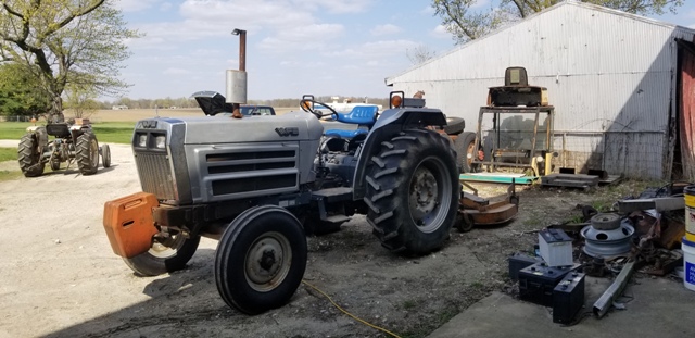

Hi Doc. I thought these were more popular than apparently are. They do move the load back about four inches and a new pin runs through the existing ball sockets on the arms. These new pins remain in place via cotter, or hitch pins and keep the sockets on the arms. the "U" bolts go around the body and lower part of the lifting arms locking the unit in place rigid. The hitch attaches, and detaches quickly like the popular weldment types with the spring loaded swinging latches in a "gullet" which grab around the implement pin. I've not known anyone to have any problems with an existing top link not being long enough myself, but have never seen another Cat II type. Seen a few Cat I on small utility type tractors but always idle. They seem to be popular around here.
Here is an Amazon link to a Cat I style which is just a bit physically smaller than what I have ordered. I've seen the lesser expensive aftermarket offerings also and my suggestion is to stay with the original. Quality is but a single reason.
 https://www.amazon.com/dp/B00U00AUNW/?_encoding=UTF8&_encoding=UTF8&pd_rd_i=B00U00AUNW&ref_=sxts_sparkle_sbv&ref_=sbx_be_s_sparkle_ssd_vid&qid=1742168353&pd_rd_w=hhW9a&content-id=amzn1.sym.8591358d-1345-4efd-9d50-5bd4e69cd942%3Aamzn1.sym.8591358d-1345-4efd-9d50-5bd4e69cd942&pf_rd_p=8591358d-1345-4efd-9d50-5bd4e69cd942&pf_rd_r=51HHFFXR9KH1MJESB3EX&pd_rd_wg=GOJDB&pd_rd_r=a9c6ed51-f498-4727-93c5-8c528c287311
My tractor is a White 2-55. I have three 75# weights on the front already which are not needed in my application, but they are there and don't hurt anything. Tractor is heavy enough on the steer axle without them for the ditch mowing I do, but I've not removed them. The little Ford will "Wheelie" coming out of the ditches with the mower deck so I hung 180# of weights on it to counter this effect. The Ford, (Shibaura) is in the background.
