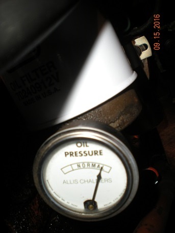

Ok, just wanted your guys opinion if I should use thinner viscosity oil?
I have removed the pan and valve cover on my 1950 WD gas engine just to clean out the sludge.
Changed the oil filter with AGCO #70240912V (is not pleated but I guess you call it stuffed)
    Used 10W-40 oil.
Before changing the filter and oil my oil pressure was barely in the normal range.
   Now the pressure maxes out the gauge.
    This is at operating temp but only running for maybe 20 min.
   I don't know what pressure that really is I'm comfortable with 60psi in a small block chevy but with this bypass type system will too much pressure cause a problem?
Does that mean that's the pressure going to the top end only?
Not too concerned now but I will be using the tractor in the winter so oil will be even thicker.
I have read the B oil filter experiment thread and didn't really see the answer I was looking for.
   Thanks in advance for any advice

I think the factory gauge, in that  position might equal about 25 PSi.  Maxed out I think 30PSI.  Keep in mind they are low revving motors, built to run for years , rule of thumb is 10 lbs per thousand of rpm...

YEP... your fine Dave.. new oil / new filter = good pressure !!

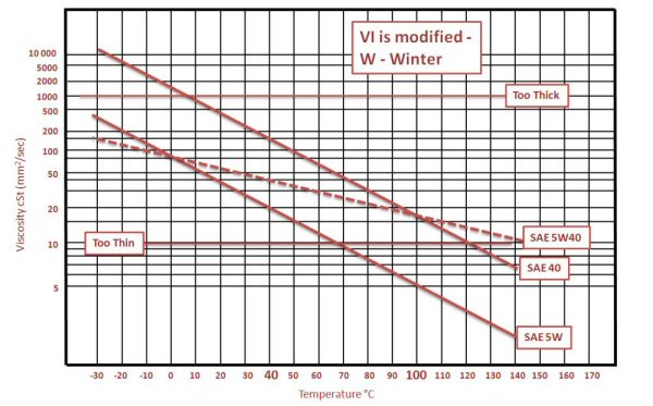

compare the viscosity of 10w40 to a 30 wt oil, or even a 10 wt oil at 20 degree ambient.  That is the whole purpose of multi viscosity oils.
Points: 89317
Post Options Post Options   Thanks (0) Thanks(0)   Quote steve(ill) Quote  Post ReplyReply Direct Link To This Post Posted: 24 Sep 2016 at 8:38am
this shows  straight weights, vs multiviscosity and why you should use use the new oils. It takes into effect the low winter temps and high summer temps to try to maintain a constant viscosity of the oil........... not 10 w 40, but you get the idea.
It's comparing apples to oranges. Chill a quart of SAE 10 and a quart of 10W-40 down to zero degrees and pour the two. You'll see a substantial difference between the two. The issue is the wax in the oil.
If you want an oil that flows easier at cold temperatures, yet keeps its film strength, go with a synthetic.

I would agree if you want better flow at LOW temps, then use synthetic.. But im not sure that is necessary in an old farm tractor motor.. 70 years ago the "cold" weather oil was called 10W  ( w = winter).... the summer oil was called SAE 30 ( no W since it was summer oil)...
THEORETICALLY there is no difference in low temp between 10W , 10W30, and 10W40..... THEORETICALLY they have the same lube quality at COLD temps.
The upper number is the characteristic at 212 degrees.
