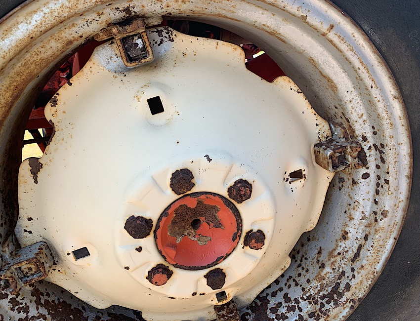

Can you good people help me with these D10 rim as to where I may find any if any such animal still exists because I sure can’t seem to find any with these square bolt hoops? I guess if it comes to it I can just buy two with the round hoops or go to power adjust rims.

The dirty little secret is is that most non PA 24" rims and centers will work, to get you going.  My D-10 is on farmall 140 centers, with british leyland rims. I had to use a plasma cutter, to remove about 1/8", from the outside center to rim bolt holes, to get the bolts to go through the metric rims, but it wasn't much work...Wink

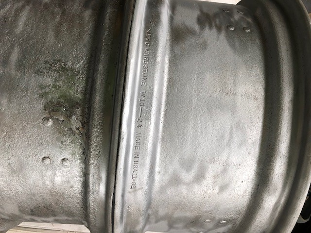

140 Farmalls have nine inch rims that look just like that if you need both. They are pretty common and fairly easy to find. My D-10 had 10 inch rims like that, and I only needed one. So I had to find a match, after three years I finally did. The rims are made by Firestone not AC. You can see Firestone stamped in mine
Can your rims not be saved? It don't look to bad.

That’s what I have on this one is 10’s.One of them isn’t too bad but the other has a nasty hole at the valve stem.I could add sheet metal and fix it But was hoping to find another one...didn’t realize these 10’s were a little hard to find.
