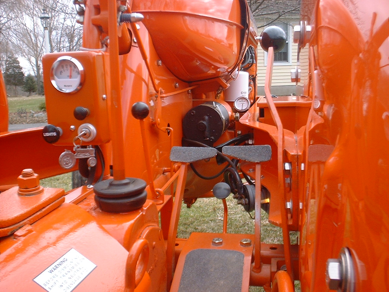

From what information I found over the years when doing my IB over about 7-8 years ago, the Battery box was normally mounted right on the left fender like in Steve's picture. Now the IB could be equipped with a lot of attachments. Mine originally had a Sickle bar on it, so the Battery box I was told and seen pics of it would mounted on the right frame rail. My Battery box (what was left of it) was mounted on top of the frame rail on the left side in front of the left fender. But the box that was mounted there was home made. When I purchased a new Battery box, I went to the right frame rail and the holes in the new box lined right up with two holes that were in the right frame rail perfectly. So I assumed, the original box was mounted there like it was supposed to be, so I remounted it there. I added a Battery shut-off and other things, but that's my own add-ons.
As for the Starter rod, in your pic, the Starter rod is hanging there like where it is in Steves picture. On my IB, mine was in the same spot. It was tough trying to get to it with my work boots on or reaching for it, so I made my own rod, put a 90 degree bend in it and put a ball on it. Makes it a bit easier to get to above the pedals. I also fabbed a support bracket at the tranny to keep it level. You can see in the pic where the Battery box is. Even though I don't have the Sickle bar, I decided to mount the Battery on the right frame rail anyway to keep it close to the Starter motor.  Hope this helps.
