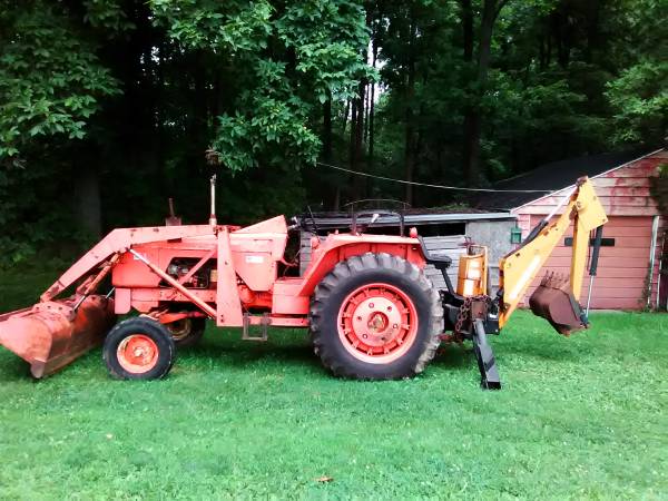

Hi guys, I found this about an hour away from me the tractor has a cracked block but in the add it says 1500 for tractor and loader. My main want is a Loader for my D-17 series 4. My question is; what model loader is this if someone can tell, and would it fit on my D-17. Thanks!

I think it would bolt right up to your Series IV. You best get the cash out and get that on your trailer. The loader is worth the asking price and the backhoe is probably worth more than the asking price. You can't go wrong on that deal, even if it didn't fit your tractor.

Its a model 500 loader, have one on a 185. No idea if it fits a D17

I have a 519 loader on my series 4

500 series. Can be made to fit your D-17 IV. Needs different brackets to rear axle ( easily fabricated) and spacer blocks between the side frames and loader frame.

I have the Model 500 on my 170D can't be to much different. It was on a 180D when I bought it.

170 and 180 use the SAME axle brackets.

Josh
You should already have that in your yard.
A 190XT with good tires, front weight, AND a hydraulic loader for $1500 !!
AND it runs !!

If the crack is external, use like it is after fixing the crack..  ;)

If it's a diesel, and the problem is antifreeze in the oil, there's a chance it's an O ring on a sleeve, not a cracked block.
