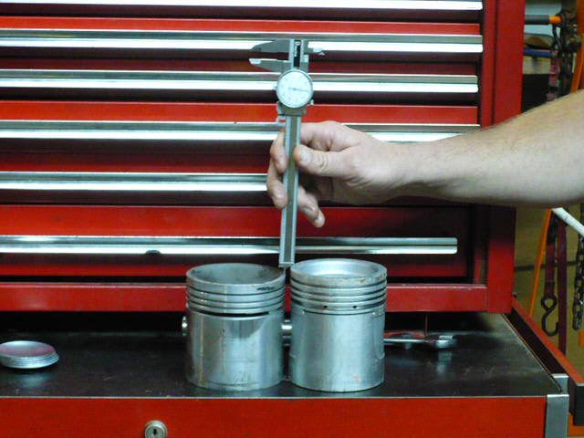

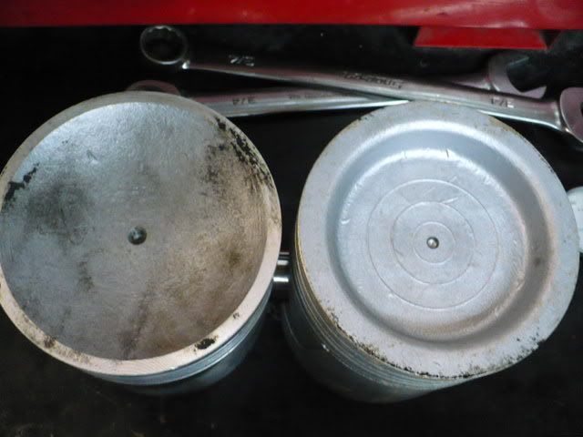

Here's two shots of D17 and 175 pistons.
I the first shot on the left is the D17 piston and on the right is the 175 piston looking from the top.
In this shot you can see the diff in height from the pin.
It's worth hunting a set of 175's.
