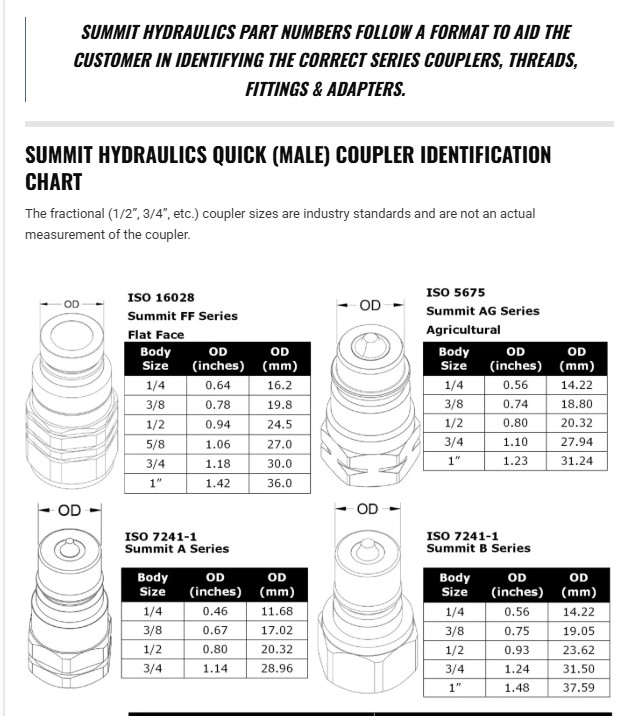

look at the end of the MALE piece.. does it have a BALL or a TIT on it... that tells you something...Most are interchangable, but the BALL is old style... Then take a caliper to comfirm " barrel size"  of various  1/2" or 3/4" types..... couple different versions... see below...
Points: 90599
Post Options Post Options   Thanks (0) Thanks(0)   Quote steve(ill) Quote  Post ReplyReply Direct Link To This Post Posted: 31 Jan 2026 at 10:16pm
this is what GOOGLE said....... 1/2 inch PIONEER 4000 series ..ISO 5675 Agricultural
The Allis-Chalmers 180 tractor typically used 1/2-inch body, Pioneer-style agricultural hydraulic couplers (often referred to as ISO 5675 or ball-style connectors).
