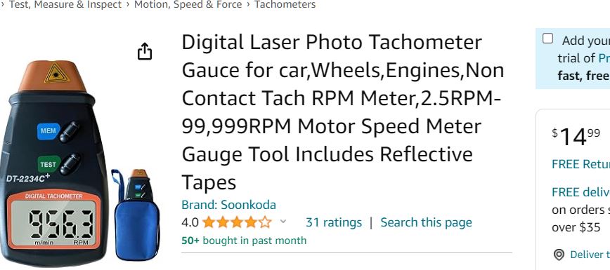

I bought one of these digital tacks for $15.  You stick a piece of reflective tape on the shaft and point the little meter at it... Works great... We were testing PTO speeds on a pump.. I also checked the drill press / lathe / band saw blade.. etc.... very handly.

Post Options Post Options   Thanks (0) Thanks(0)   Quote lost in h3 Quote  Post ReplyReply Direct Link To This Post Posted: 26 Mar 2024 at 10:18am
that sounds good. cheap!

Post Options Post Options   Thanks (0) Thanks(0)   Quote lost in h3 Quote  Post ReplyReply Direct Link To This Post Posted: 28 Mar 2024 at 6:54pm
Thank you for the reply Fred. I'll give it a try, currently waiting on a tachometer.
